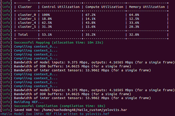

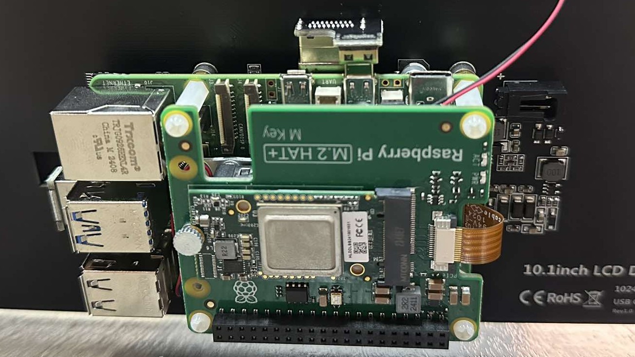

Thanks for all the advice everyone, now I can do it perfectly using SciPy==1.8.1 and NumPy==1.23.3 Thank you from the bottom of my heart. Now I can use a her file to work perfectly on my Raspberry Pi 5 from the YOLOv11 model complied by DFC 3.30.

Thank you very much. I love it so much. I can create devices that are fast and use less power compared to the GPU in computers. I didn’t think that deploying out models after compiling would be this easy. So cool!
