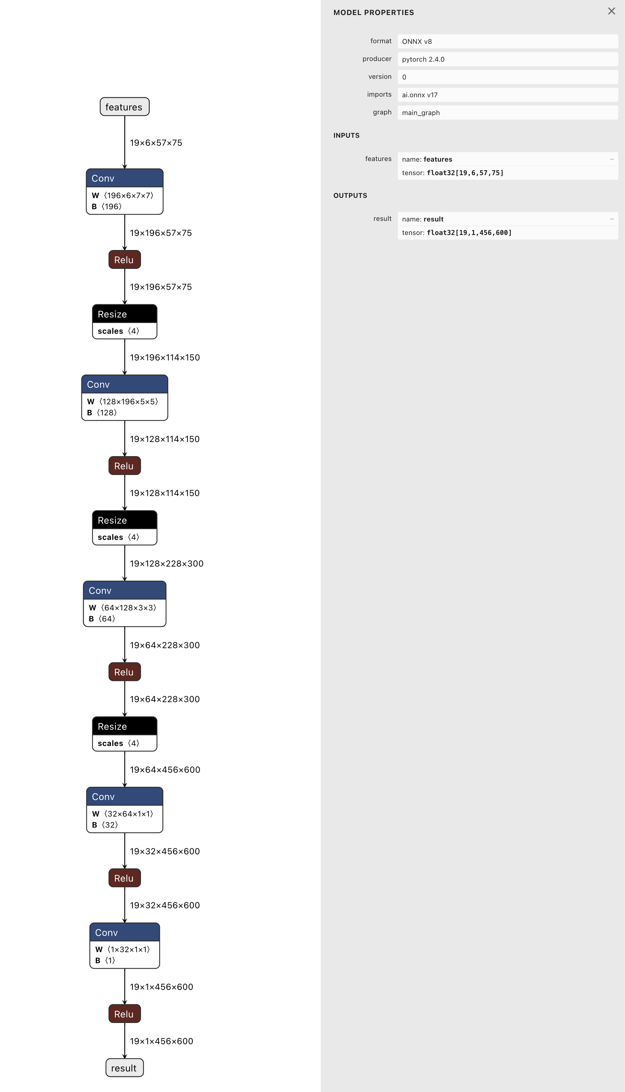

I have a simple regressor model that I’m trying to use with Hailo.
For information, it’s definition in PyTorch is this:
        self.regressor = nn.Sequential(
            nn.Conv2d(input_channels, 196, 7, padding=3),
            nn.ReLU(),
            nn.UpsamplingBilinear2d(scale_factor=2),
            nn.Conv2d(196, 128, 5, padding=2),
            nn.ReLU(),
            nn.Conv2d(128, 64, 3, padding=1),
            nn.ReLU(),
            nn.Conv2d(64, 32, 1),
            nn.ReLU(),
            nn.Conv2d(32, 1, 1),
            nn.ReLU(),
The inputs to this model come from a ResNet50 features map, so the input tensor is a 4D shape (actually it’s 5D but I remove the batch to simplify).
After the conversion from PyTorch to ONNX, I use ONNXSIM to simplify and the result is this:
The input shape is : float32 [19, 6, 57, 75]
The output shape is: float32 [19, 1, 456, 600]
I start the process of conversion to HAR, inside a new docker environment of AI Suite, using the “hailo parser” to convert to HAR:
hailo parser onnx
--hw-arch hailo8
--net-name famnet
--har-path ./hailo_models/famnet_converted_model.har
--start-node-names features
--end-node-names result
--tensor-shapes "features=[19, 6, 57, 75]"
--parsing-report-path ./hailo_models/parser_report.txt
models/FamNet_600_sim.onnx

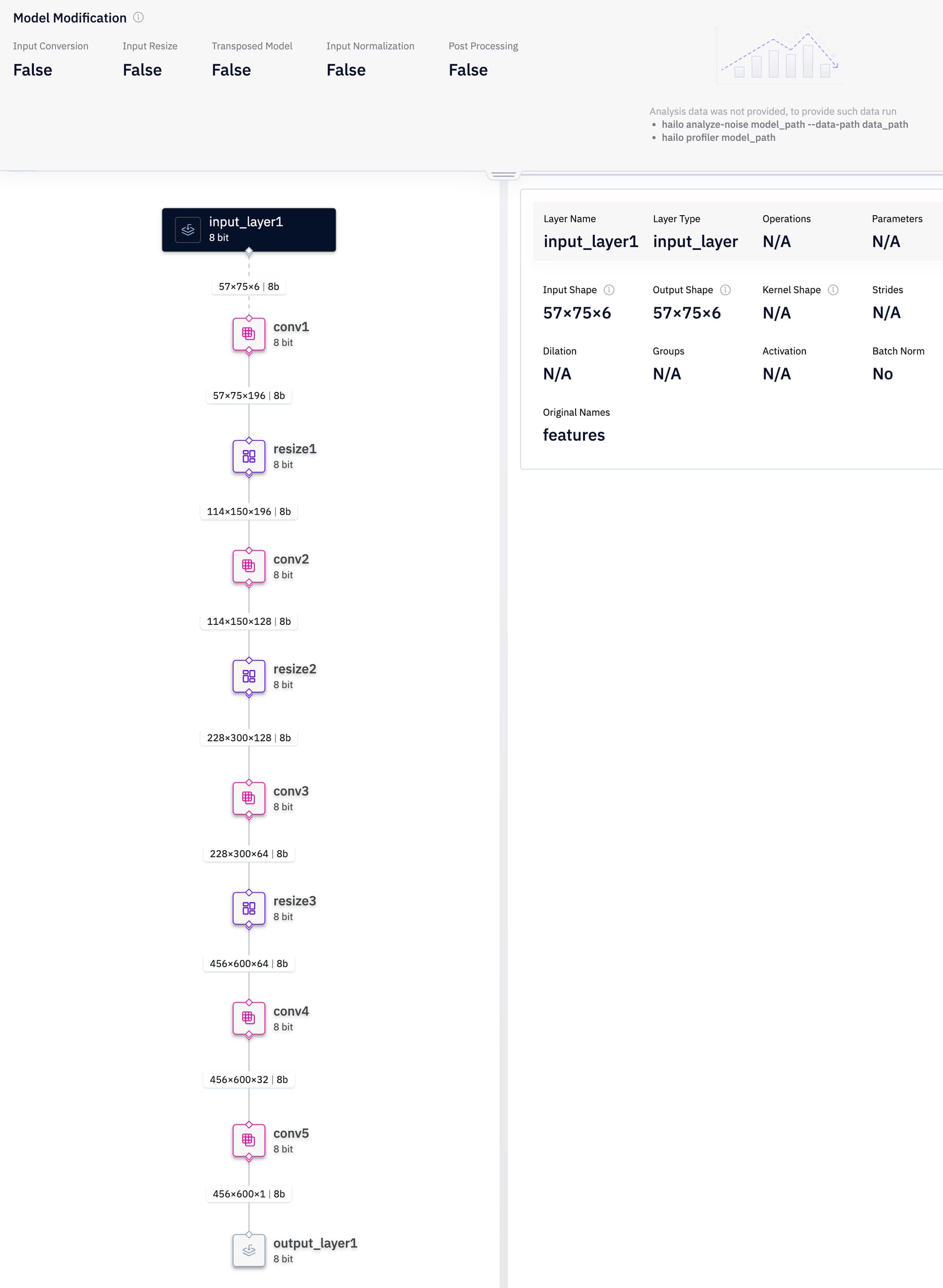

However, when I check the HAR using “hailo profiler” I see this:
Which says that my input tensor is a [57 x 75 x 6] dimension and my output is a [456 x 600 x 1]. It seems during the conversion from ONNX to HAR the process squeezed the input and the output shape, removing 1 dimension.
This is a big problem as I need the 19 maps.
What can I do to preserve the model input shapes during the conversion to HAR ?
Thank you
Regards,
Hi @pedrosantos,
Thank you for the detailed question, the DFC removes the batch dimention since we treat it in runtime (only). So, it’s irrelevant from the compiler POV.
I hope that this makes sense.

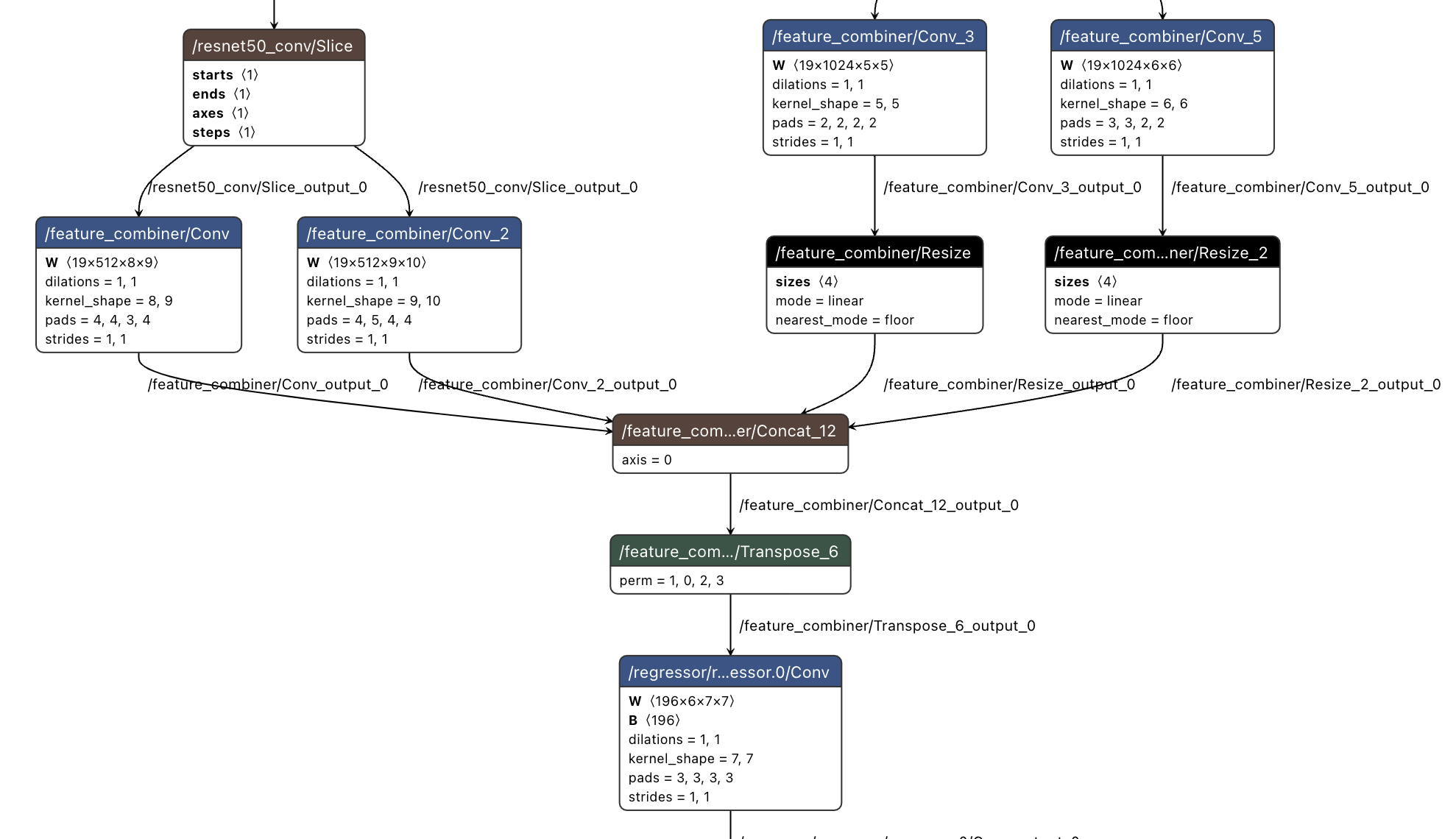

I’m close to successfully converting the ONNX model to HAF format, but I’m encountering issues with these two operations: CONCAT and TRANSPOSE:
hailo_sdk_client.tools.parser_cli.ParsingWithRecommendationCLIException: Parsing failed. The errors found in the graph are:
UnsupportedConcatLayerError in op /feature_combiner/Concat_12: Unsupported concat over axis 0
UnsupportedShuffleLayerError in op /feature_combiner/Transpose_6: Failed to determine type of layer to create in node /feature_combiner/Transpose_6
I read the DFC documentation and I saw that these operations are supported but with some caveats.
I tried different things but I’m not able to remove the concat or the permutation operation from my model definition.
Can someone give some help on how I can successfully convert this model to HAR ?
Maybe some way on how to make these operations work for the conversion or how I can substitute these operations by other hailo friendly operations that do the same.
Any assistance is appreciated.
Thank you,
Regards.
if it helps, this is the graph from the ONNX file with the 2 operations:
That means that if your data is indeed 4D + 1D for batch, it would pose a problem for the compiler. if the 5D op is only on the margins and the bulk of hte model is in 4D, you can omit that node from being run on Hailo
Transpose is a problematic op for the DFC, especially if it operates on the batch dimension as in the above example.
Some options to address:
  1. If this is the last op, remove it from the HEF
  2. Change the conv such that he transpose will not be required.
  3. Divide to 2 HEFs, do the transpose on the host
