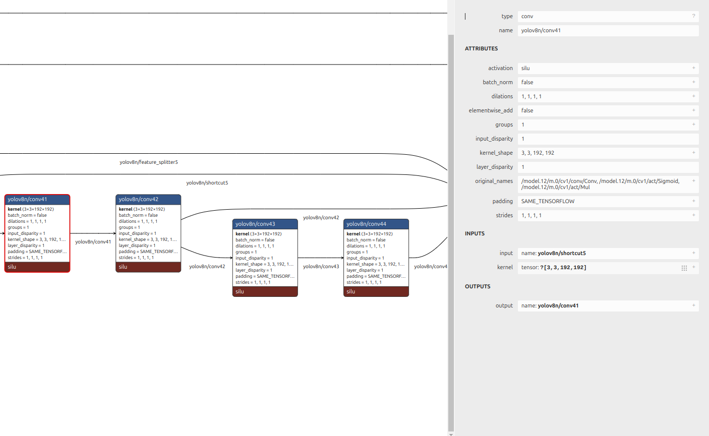

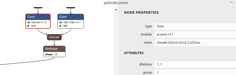

Yolov8s/conv41 doesn't have one output layer
Hi,
i am running into this error while trying running
hailomz compile yolov8s --ckpt=best.onnx --hw-arch hailo8l --calib-path train/images/ --classes 3
Any idea where might be my error? i am still new and learning.
Thank you for any help.

When converting a model using the hailomz tool, some layers at the beginning or at the end of the model may be removed during parsing, according to the start and end nodes specified in the configuration YAML file.
Not sure if you are suing Yolov8s or Yolov8n (it seems to be Yolov8n from your screenshot, but you mentioned Yolov8s in the title).
For Yolov8s, the default YAML file used by the hailomz is this one, which is intended to work with the Yolov8s ONNX model available in the Hailo Model Zoo.
As you can see in the YAML, the specified end nodes are:
- /model.22/cv2.0/cv2.0.2/Conv
- /model.22/cv3.0/cv3.0.2/Conv
- /model.22/cv2.1/cv2.1.2/Conv
- /model.22/cv3.1/cv3.1.2/Conv
- /model.22/cv2.2/cv2.2.2/Conv
- /model.22/cv3.2/cv3.2.2/Conv
These names correspond to the last Conv layers before the Concats
Since you are using your own model, I suggest checking if the names of those nodes changed. If so, you can create a new version of the YAML that you can pass as an argument to the hailomz command, with the --yaml option.
Let me know if this works for you.

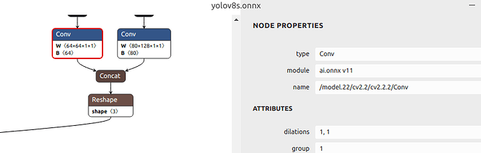

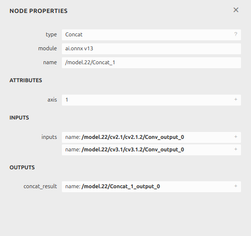

Thank you for your help. My mistake with naming of topic, you are right aboout using yolov8n.
I checked my onnx and i dont think that nodes changed.
All three concats poiting to right named nodes.

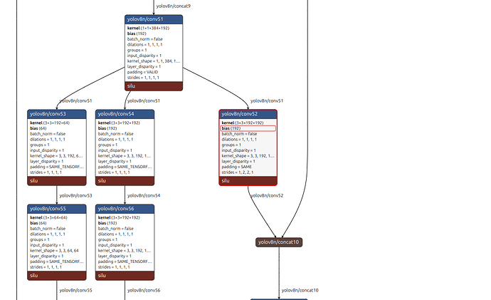

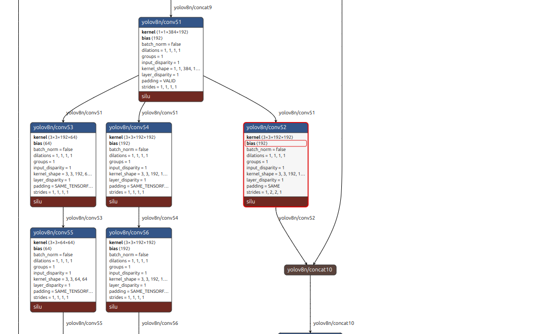

I checks .json file and my HAR output and maybe found problem:

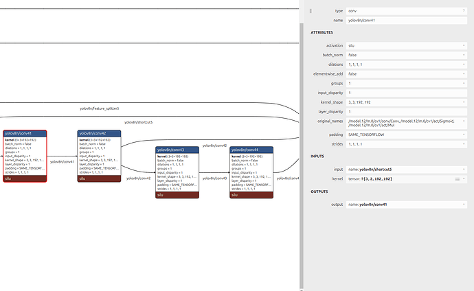

Still not sure if i identified problem layer correctly but tried to create new modifed YAML but with no sucess. Still same layer 41 output error.
