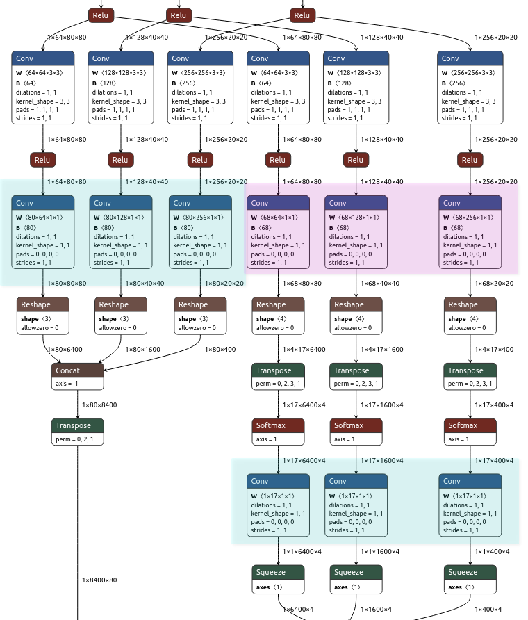

You want the names of the cyan convolutions.
For me these are (from left to right):
/model/heads/head1/cls_pred/Conv
/model/heads/head2/cls_pred/Conv
/model/heads/head3/cls_pred/Conv
/model/heads/Conv
/model/heads/Conv_1
/model/heads/Conv_2
If that doesn’t work, I would try the first cyan block with the magenta block:
For me these are:
/model/heads/head1/reg_pred/Conv
/model/heads/head2/reg_pred/Conv
/model/heads/head3/reg_pred/Conv
You can find the names in your onnx in Netron.

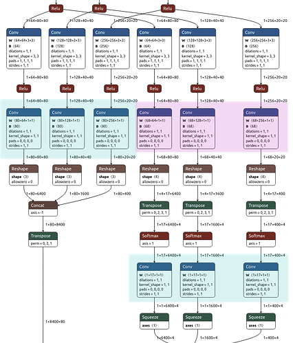

Thank you, here is the output of yolo-nas in flat output format. Should I only be looking at the later areas where there is a row of blue conv nodes? How do you know the name (/model/heads/head1/cls_pred/Conv vs /model/heads/Conv)?
Yes, look near the bottom where you should see an identical graph. Click on the Conv to see the name, it will appear in a panel on the right hand side of Netron.
