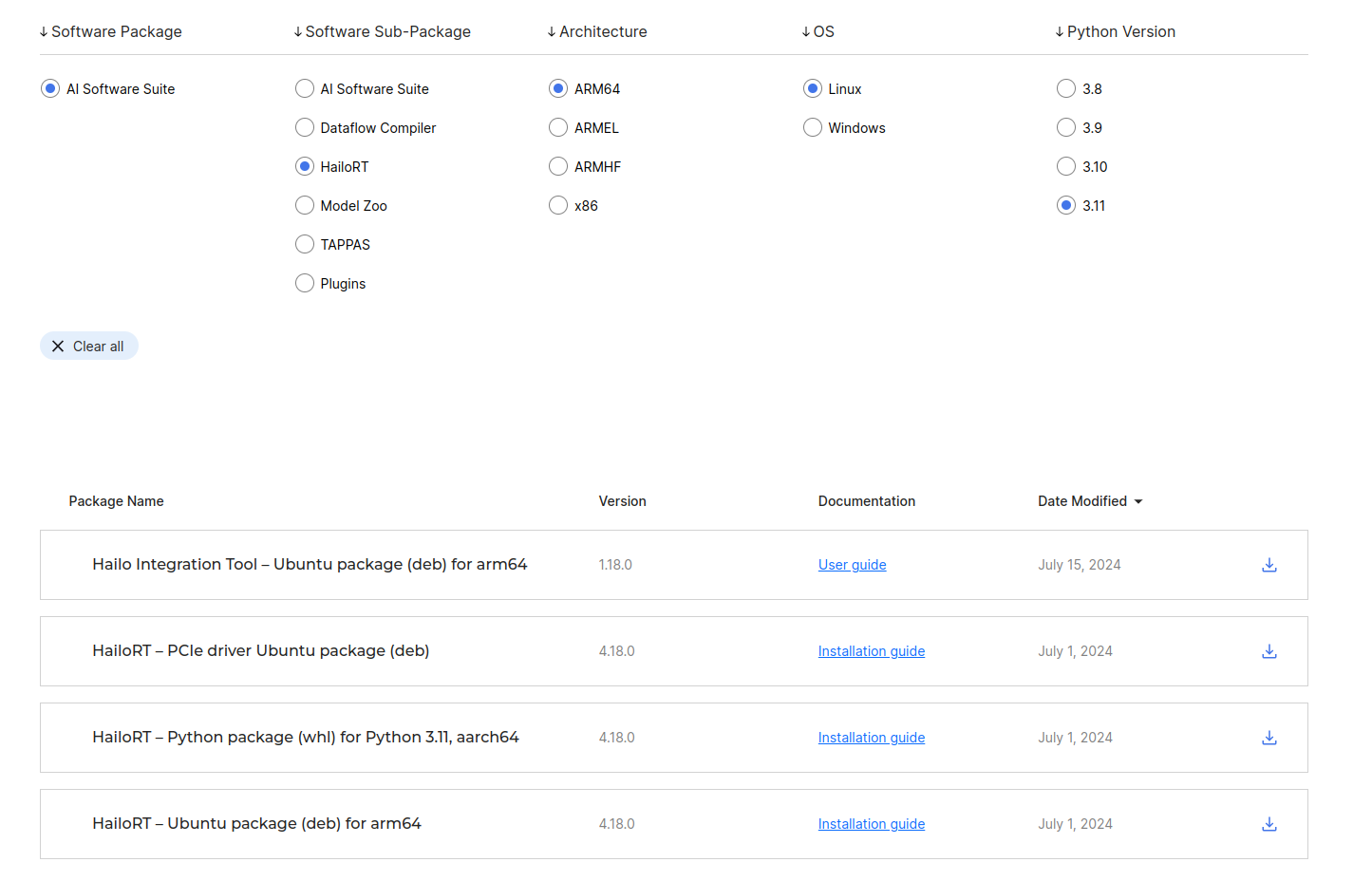

There is not link and website to download hailort4.18.0 deb file.
  • Visit the Hailo Developer Zone Software Downloads page: https://hailo.ai/developer-zone/software-downloads/
  • Download the following files (as shown in the screenshot):
    • The second file: This is the driver
    • The third file: This is pyHailoRT
    • The last file: This is HailoRT
  • Once downloaded, install these components manually, following a similar process to how you installed the driver initially.
This manual installation of the latest HailoRT components should resolve the version mismatch you’re experiencing with the hailo-all package.
If you need any further guidance on the installation process for these specific files, please don’t hesitate to ask.
Best regards
