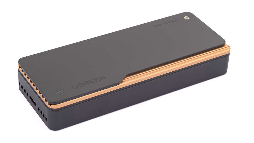

This guide provides step-by-step instructions for setting up and using the UGREEN USB4 M.2 NVME SSD Enclosure with Hailo-8/8L and Hailo-10H M.2 modules on devices with Thunderbolt support. Whether you’re using a laptop or desktop, this guide will help you identify the device or variant in an online store and ensure compatibility and proper installation.
Below are images to help identify the device when purchasing online.
The device might also be shown with a silicon sleeve, which is included in the original box but may be optional.
Specifications
Here are some parameters that may help you search for or identify the adapter, or find alternative versions. These adapters are often slightly modified by the manufacturer.
  • Model: CM642
  • Product Name: UGREEN USB4 M.2 NVME SSD Enclosure
  • Chip Used: ASM2464 (USB4/Thunderbolt controller from Asmedia)
Cables
The box includes two cables. To use the enclosure with a Hailo module, you must use the Thunderbolt cable with two USB-C connectors. The USB-A type connector cable will not work.
