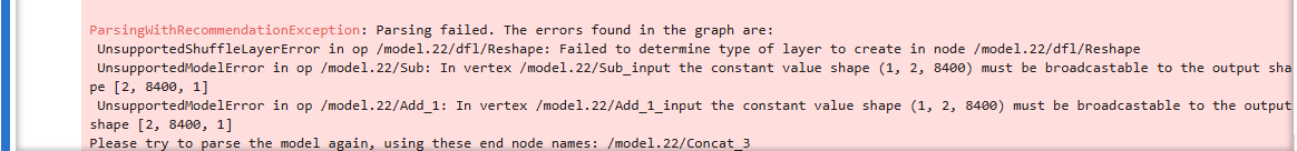

I used Netron to visualize my onnx model and my har model.I believe that since I put “/model.22/Concat_3” as the only end node in the end_node_names argument, the parser only parsed the onnx model until that layer. However, the final concat layer in the visualization is “/model.22/Concat_5”. However, when I try to put “/model.22/Concat_3” and “/model.22/Concat_5”, or only “/model.22/Concat_5” in the end_node_names argument, I get an error that looks like this:
The only way I am able to run this cell without getting an error is by only providing “/model.22/Concat_3” as the singular argument. Which end nodes should I use?
