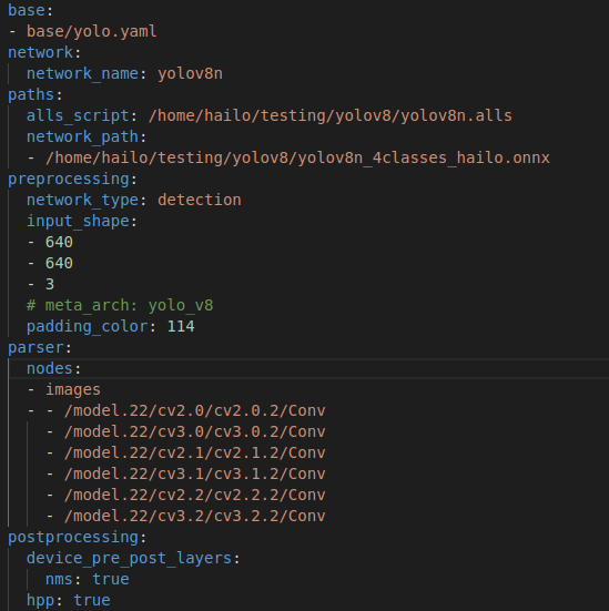

I am trying to compile Yolov8n onnx to hef to infer on HAILO8. Model was trained using Hailo Model Zoo. After model`s export to hef it cannot find anything on images. Yolo config in attachments. Where is mistake?

I see in the yaml file that you passed a custom model script (.alls) path. Could you please confirm the commands that are in it?

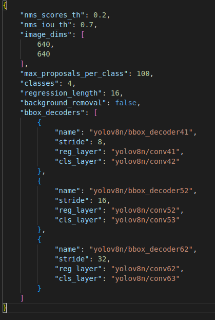

nms_postprocess(“/home/hailo/testing/yolov8/yolov8n_nms_config.json”, meta_arch=yolov8, engine=cpu)
yolov8n_nms_config.json in attachments.

@anton.lukanov thank you for sharing, the files seem correct.
