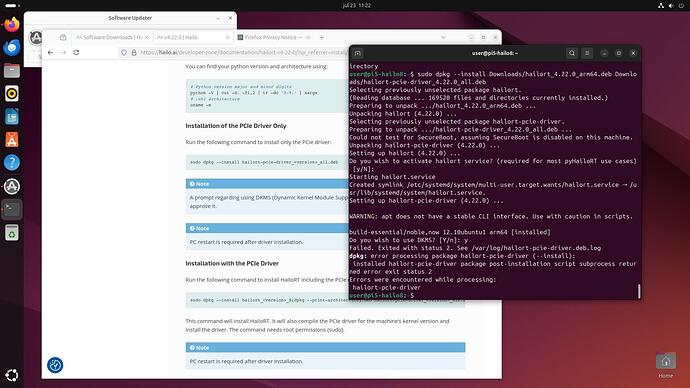

Trying to install the 4.22 package for Ubuntu 24.04 on a RPi5 8GB RAM with a fresh 24.04, just installed the necessary packages.
I got stucked…

Could you let me know which kernel version you’re running? I’m pretty sure this is a kernel compatibility issue - we’ve seen this before when people try to use kernels that aren’t officially supported.
Also just to mention, we don’t have official support for Ubuntu 24 yet, so that’s likely what’s causing the problem.
Let me know what kernel you’re on and we can figure out the best way forward.

linux 6.8.0-1018-raspi
I tought 24.04 was supported from 4.22.0, but I guess my kernel is too new.
