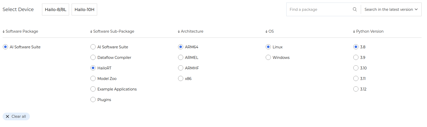

Have you already tried manually installing HailoRT for ARM using the official website https://hailo.ai/developer-zone/software-downloads/?
Try installing HailoRT and if the hailortcli works, you can run the examples. You can also download the TAPPAS repository and try the examples there.

Like @Adrian_Araya mentioned, you’ll need to download and install them manually. I’d suggest following the installation guide that comes with HailoRT - it should walk you through everything step by step.
