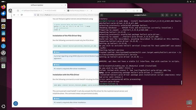

RPi5 Ubuntu 24.04LTS HailoRT 4.22
Trying to install the 4.22 package for Ubuntu 24.04 on a RPi5 8GB RAM with a fresh 24.04, just installed the necessary packages.
I got stucked…
Regards
Michael

linux 6.8.0-1018-raspi
I tought 24.04 was supported from 4.22.0, but I guess my kernel is too new.

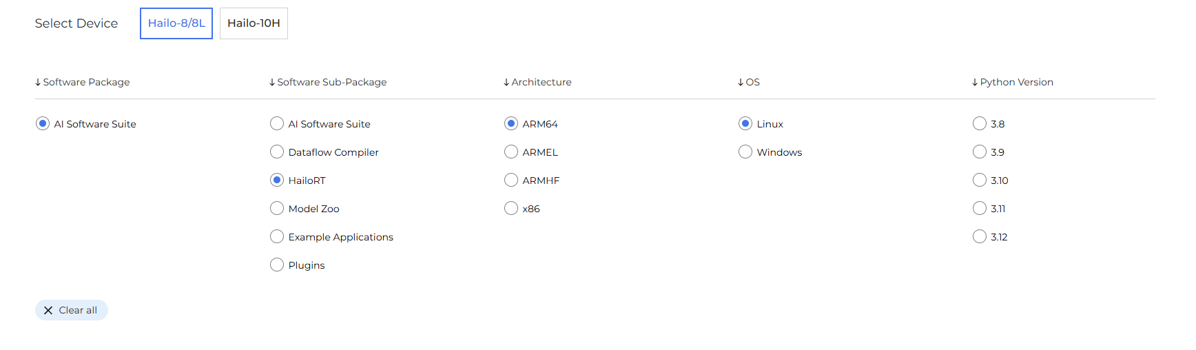

I’d recommend going with the ARM packages for your Ubuntu setup. You can see the options in the image I attached.
You’ll want to download:
  • The Hailort driver 4.20 or 4.22 for ARM
  • HailoRT 4.20 or 4.22 for ARM
  • TAPPAS core
  • TAPPAS core Python bindings
  • HailoRT Python bindings for ARM
That should get you set up properly. Let me know if you run into any issues with the installation!
