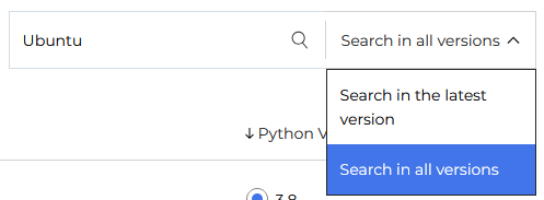

Search for ‘Ubuntu’ and make sure you click ‘Search in All Versions’ here:
