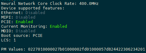

Thanks Nadav, that is very helpful. I would also be interested in querying which temperature zone HAILO is in as well as the current clock frequency through the python interface. Is that possible?
You can use the device control:
from hailo_platform import Device
dev = Device()
dev.control.get_extended_device_information()
This would output like this:
Temperature zones are preset, you can read the values in the hailort user guide in this chapter: “9.1. Temperature Monitoring”
