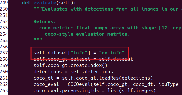

I’m using Hailo Model Zoo v2.15.0
I found the source of the problem. The function evaluate in core/eval/detection_evaluation.py does not set the “info” entry of the dataset
and pycoco does not check it during loadRes:
As a workaround, I set the info as follows:
And now, the command works.

Hi @Ian_Ruvuto,
First, the two numbers in your own output are not in conflict, and reading them right changes what you are chasing.
Done 1500 images AP=0.042 AP50=0.076 is not a different result from the COCO block above it. It is the same result multiplied by 100. log_accuracy in hailo_model_zoo/core/infer/infer_utils.py:63-69 does norm_coeff = 100.0 if result.is_percentage else 1.0 and then formats with {:.3f}; detection eval never overrides is_percentage, which defaults to True in hailo_model_zoo/core/eval/eval_base_class.py:27-28, and _get_accuracy in hailo_model_zoo/core/eval/detection_evaluation.py:270-273 just hands back coco_eval.stats[0] and stats[1] — the very values pycocotools printed. So:
your log line actual COCO value what pycocotools printed
AP=0.042 0.00042 0.000
AP50=0.076 0.00076 0.001
Both reconcile exactly. Your AP is not 4%, it is 0.04% — effectively nothing is matching at all. The earlier Done 1000 images AP=0.191 AP50=0.286 in this thread is the same story: AP 0.0019, not 19%.
That matters because a near-zero AP is not a quantization signature. On a Hailo-8L (HailoRT 4.23, DFC 3.33) I measured a quantized yolov8n keeping ~100% of its COCO box mAP50 against the float model; the int8 step on a v8n detect head costs almost nothing, no matter how many classes you have. Quantization degrades an AP, it does not annihilate it. An AP of 0.0004 with non-zero recall means boxes are being produced and then scored against the wrong labels.
The control that settles it, same eval on the float model:
hailomz eval yolov8n --har yolov8n_custom.har --data-path my_val.tfrecord --target full_precision --hw-arch hailo8l
If full_precision also lands near zero, quantization is ruled out and the problem is entirely in the dataset/postprocess.
Two traps that produce this on a custom model:
  1. Ground truth. If the eval runs against the stock COCO tfrecord (coco_val2017.tfrecord), your custom class ids never match COCO’s categories and AP collapses to roughly this. You need a tfrecord built from your val split with your category ids, not the stock COCO one.
  2. The COCO label remap. The traceback earlier in this thread goes through detection/nanodet.pydetection_common.tf_postproc_nms(..., coco_2017_to_2014=True). That remap plus the COCO labels_offset changes the order of your class ids, so even correct boxes get scored against the wrong category. --classes 7 does not rewrite that path, which is why it looks like it has no effect. The postprocess config has to point at your own label space: classes = N, and no coco-2017→2014 mapping.
A quick sanity check before trusting any AP number: draw the raw detections on 4-5 images. If the boxes land on the objects but AP stays near zero, it is a label/GT mismatch and int8 is not your problem.
Hope this helps.
