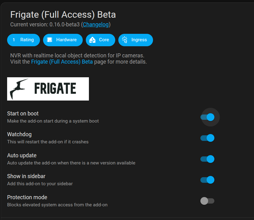

Home Assistant Add On installation
We’ve successfully tested the Home Assistant add-on integration with Raspberry Pi 5.
To use it, ensure your Home Assistant installation is updated to version 2025.5.3 or later. This update is crucial as it includes the necessary Hailo Driver (version 4.20).
The Frigate release that introduced Hailo support to the main repository is Release 0.16.0-beta3. As this is still a beta version, you’ll need to select the Frigate (Full Access) Beta add-on for installation within Home Assistant.
Note that you need to disable Protection mode in order to allow it to use Hailo.

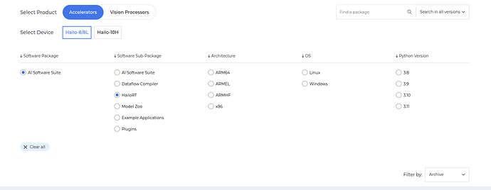

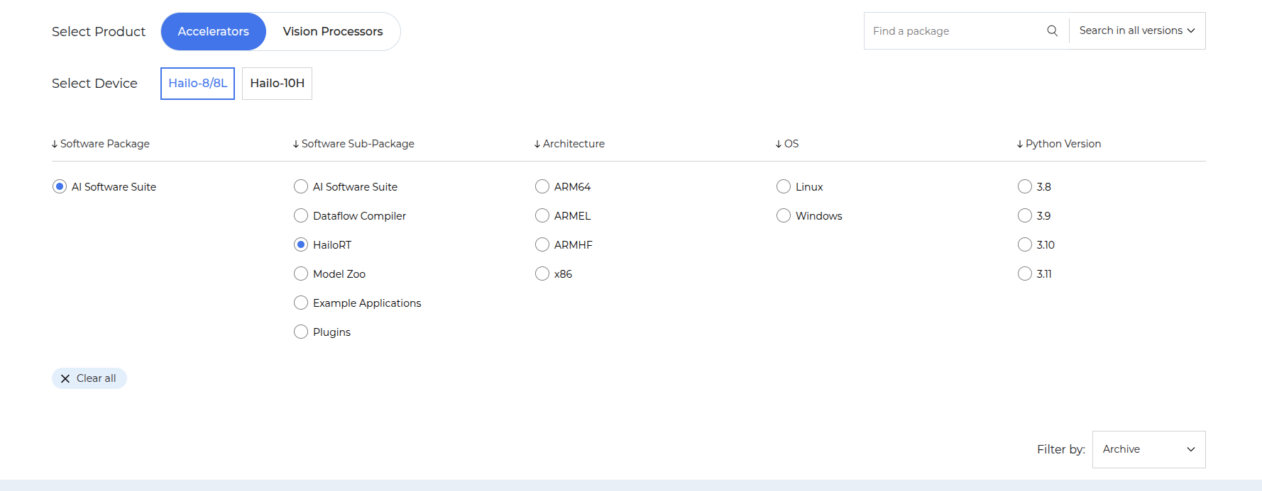

Hey @user223 ,
This is how you find 4.20 in our software downloads , you will find them under!
