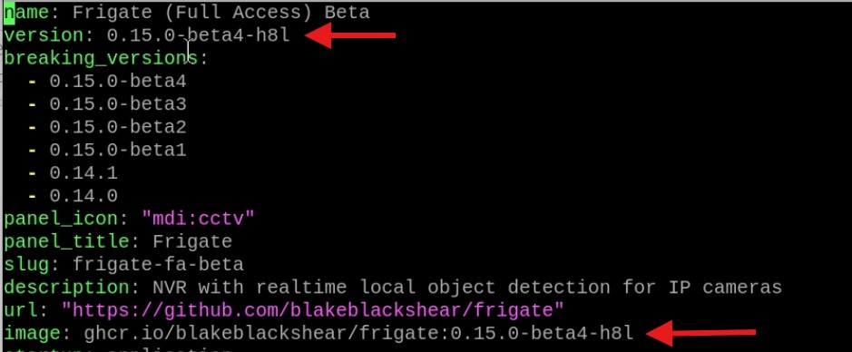

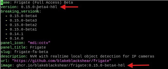

notes: I am using AI kit + (not the M.2 type) can this the issue
Finally manage to make it work
the problem is on config.yaml for downloading the correct images should be like below
will upload performance later
Had the same issue and moved to Frigate beta 15.1. This sorted the “Type” issue
