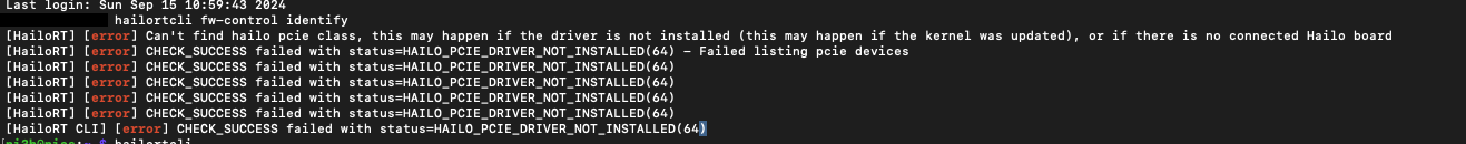

Hailo 8L installation issue
I tried to install Hailo 8L to my pi5, but got following error

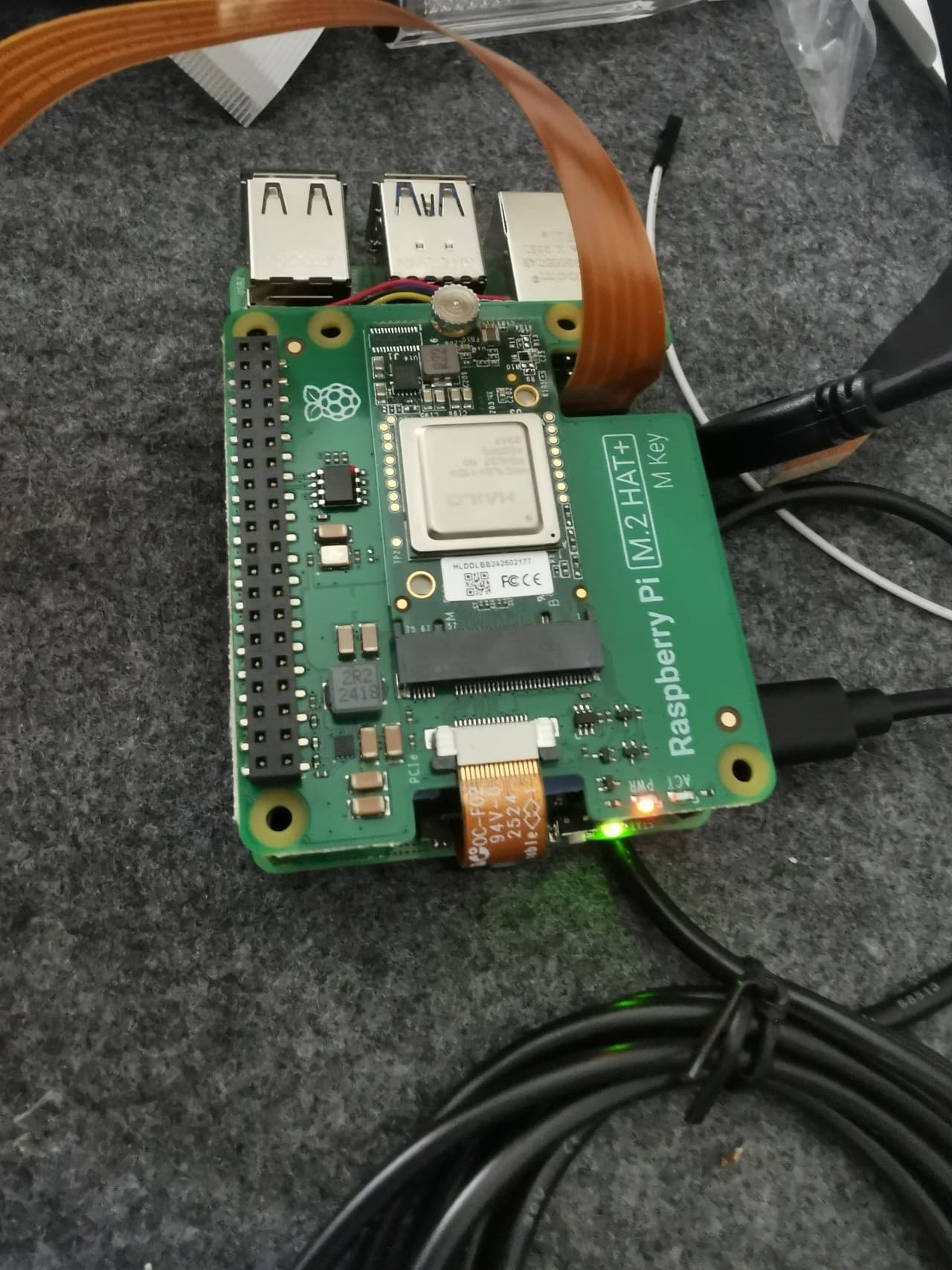

The PWR light is on.
Hey @yimingliu0216,
Did you install it using sudo apt install hailo-all and follow the setup guide provided here?
It looks like the driver installation might not have been successful. I recommend trying to reinstall it, and don’t forget to reboot afterward, as that often resolves the issue.
Hey @omria ,
I did reinstall hailo-all several times. And not fix the issue.
Can you remove all Hailo installations, including hailo-all, from the Raspberry Pi and start fresh? Sometimes, hailo_pcie or the firmware gets locked to a specific version, which can cause issues with model compatibility.

Thanks @omria ,
I reinstall a raspberry pi os and it works.
One thing I did different, before I use pi4 charger, which only support A3. I used new pi5 charger now.
Looks like the kid is sensitiive the voltage.
