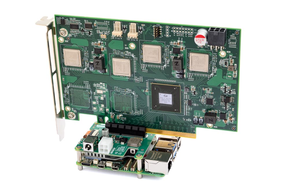

I recently decided to have some fun with my Raspberry Pi 5 by adding a Lanner Falcon-H8. My version of the Falcon-H8 has four Hailo-8 AI accelerators providing a total of 104 TOPS. To make this work, I used a Raspberry Pi HAT from Pineboards.
Here’s an image of my setup (without the heatsink):
As you can see, the Raspberry Pi 5 is connected to the Falcon-H8 PCIe card via the Pineboards HAT. The HAT makes it easy to integrate the PCIe card with the Raspberry Pi because the PCIe slot is open-ended and has a separate power connector, so it will not fry your Pi. I used a 12V 5A power supply with a barrel jack connector.

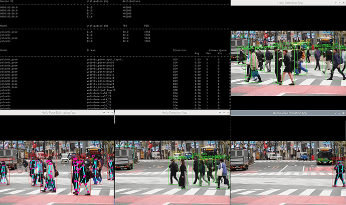

I have been running multiple instances of the applications from our Hailo RPi 5 Example repository.
Here’s an image of two Object Detection and two Pose Estimation examples in action:
You can see the four devices in the HailoRT CLI Monitor.
