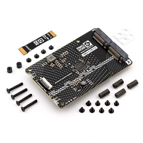

This week I received Raspberry AI kit from Pimoroni, currently I am using Raspberry pi 5 with SSD which is already using PCI cable also known as M2. How do I connect both SSD and this AI kit to M2 at the same time?
@ramkumarkoppu The Raspberry Pi 5 only has a single PCIe lane available to connect hardware. Therefore you can only connect a single PCIe device.
There are some M.2 HATs that have a PCIe switch where you can connect multiple PCIe devices to. They will share the bandwidth of the single PCIe lane. This will limit the performance of both devices.
I will receive one of these boards in the next day or so. I will let you know whether it works.
Hi, the Pimoroni NVME Duo base has been tested and it can run both NVME storage and the Hailo at the same time. I have just ordered one to come with my Hailo pre-order.
