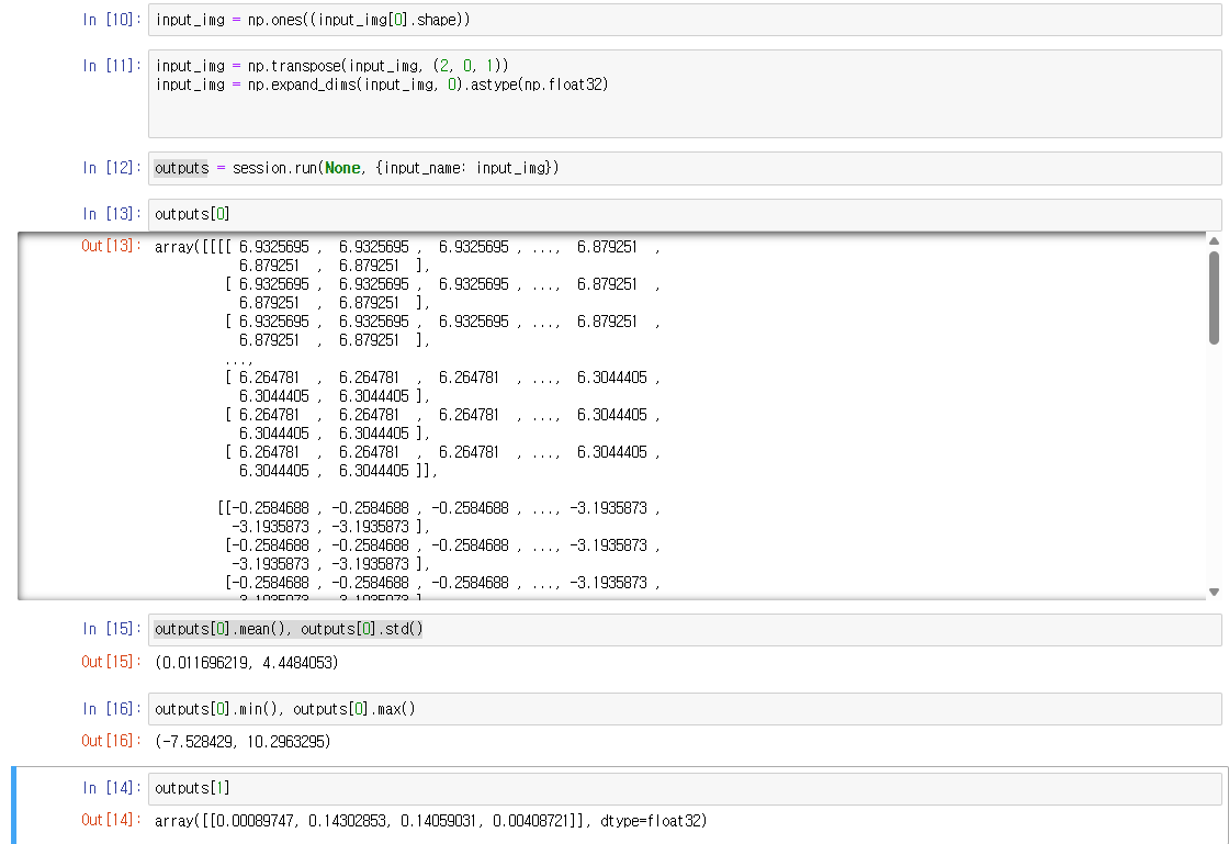

Symptoms
- Intermediate tensors and final outputs diverge between onnxruntime and Hailo runtime, including on constant inputs.
- Discrepancies persist across opset/DFC variants and after BN insertion.
