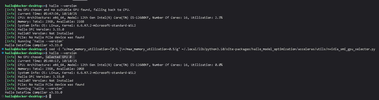

HOWEVER, the root issue is quite simple. The select_least_used_gpu() function is not returning any GPUs due to a very small default memory usage limit.
You can fix this with a simple one-liner when you’re inside the container. This needs to be run each time you restart the container
sed -i 's/max_memory_utilization=[0-9.]\+/max_memory_utilization=0.5/g' $HOME/.local/lib/python3.10/site-packages/hailo_model_optimization/acceleras/utils/nvidia_smi_gpu_selector.py

If it still isn’t working, make sure you’re running the docker container with the nvidia runtime. Run this under your WSL distro and make sure nvidia-smi returns a reasonable result.
sudo docker run --rm --runtime=nvidia --gpus all ubuntu nvidia-smi
