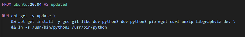

Dockef file use Ubuntu 20.04
Then I prepared packages

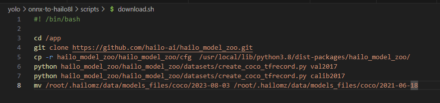

And zoo data
(Btw, as you may see to make things workable I had to do a couple tricks - override cfg folder and rename coco data folder. It would be pretty nice if model zoo will not have these bugs)

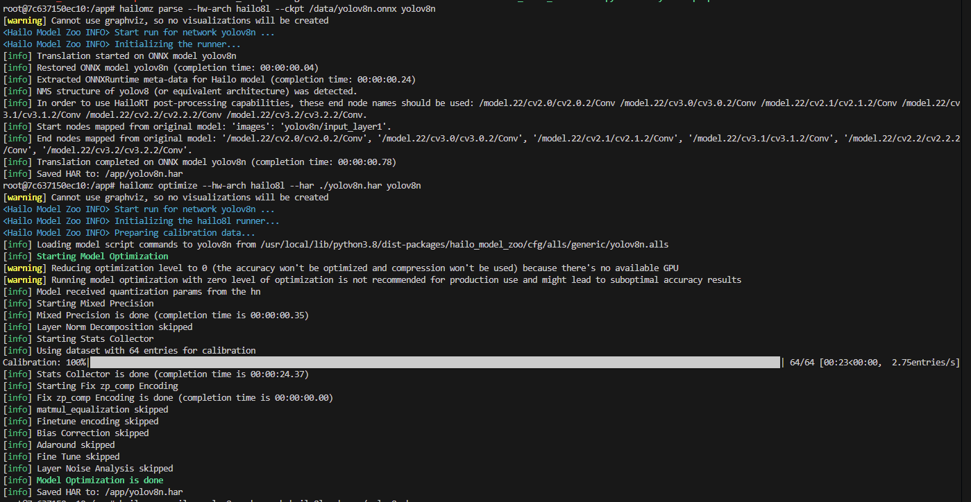

And then parse, optimize and compile model
It parsed and optimized well.

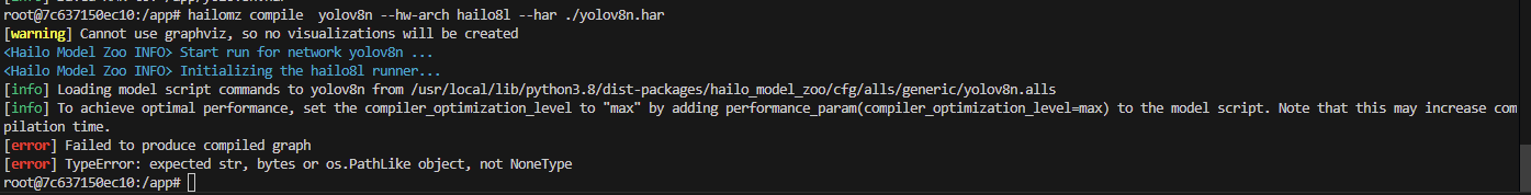

But on comilation it failed.
How can I fix this?

It seems that your overriding of the cfg files is causing the issue. One of the important steps for yolov8 is setting the start and end node names, which is done automatically if you pass the yolov8 arch name. This is necessary because the post-process is not natively supported, instead, it’s added back to the model during the optimization with the nms_postprocess command.
