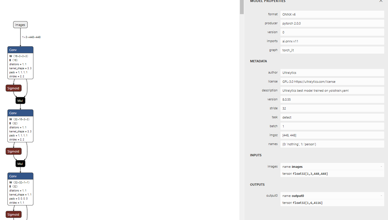

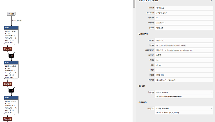

I trained a model with yolov8s and yolov8n using the instructions and dockerfile from here: hailo_model_zoo/training/yolov8 at master · hailo-ai/hailo_model_zoo · GitHub
In Yolo Docker:
yolo detect train data=/app/yolotrain.yaml model=yolov8s epochs=100 batch=16 imgsz=446 name=8s_v1.0
yolo detect train data=/app/yolotrain.yaml model=yolov8n epochs=100 batch=16 imgsz=446 name=8n_v1.0
yolo export model=/workspace/ultralytics/runs/detect/8n_v1.0/weights/best.pt imgsz=448 format=onnx opset=11
yolo export model=/workspace/ultralytics/runs/detect/8s_v1.0/weights/best.pt imgsz=448 format=onnx opset=11
I then copied those to my hailo_ai_sw_2024-07.1_container so that I can compile (or parse, optimize, then compile, I’m still a little foggy on why some tutorials skip straight to compile and others parse and optimize)
I updated my yolo.yaml to account for the new input size:

but I get the same error if I try and compile or optimize:
hailomz compile yolov8s --hw-arch hailo8l --har ./yolov8s.har --calib-path ./training/yolo/images/
<Hailo Model Zoo INFO> Start run for network yolov8s ...

(hailo_virtualenv) hailo@docker-desktop:/jtech$ hailomz compile yolov8s --hw-arch hailo8l --har ./yolov8s.har --calib-path ./training/yolo/images/
<Hailo Model Zoo INFO> Initializing the hailo8l runner...
<Hailo Model Zoo INFO> Preparing calibration data...
[info] Loading model script commands to yolov8s from /local/workspace/hailo_model_zoo/hailo_model_zoo/cfg/alls/generic/yolov8s.alls
[warning] Reducing optimization level to 0 (the accuracy won't be optimized and compression won't be used) because there's no available GPU

and for 8n:
hailomz compile yolov8n --hw-arch hailo8l --har ./yolov8n.har --calib-pa
<Hailo Model Zoo INFO> Start run for network yolov8n ...
[info] Loading model script commands to yolov8n from /local/workspace/hailo_model_zoo/hailo_model_zoo/cfg/alls/generic/yolov8n.alls
