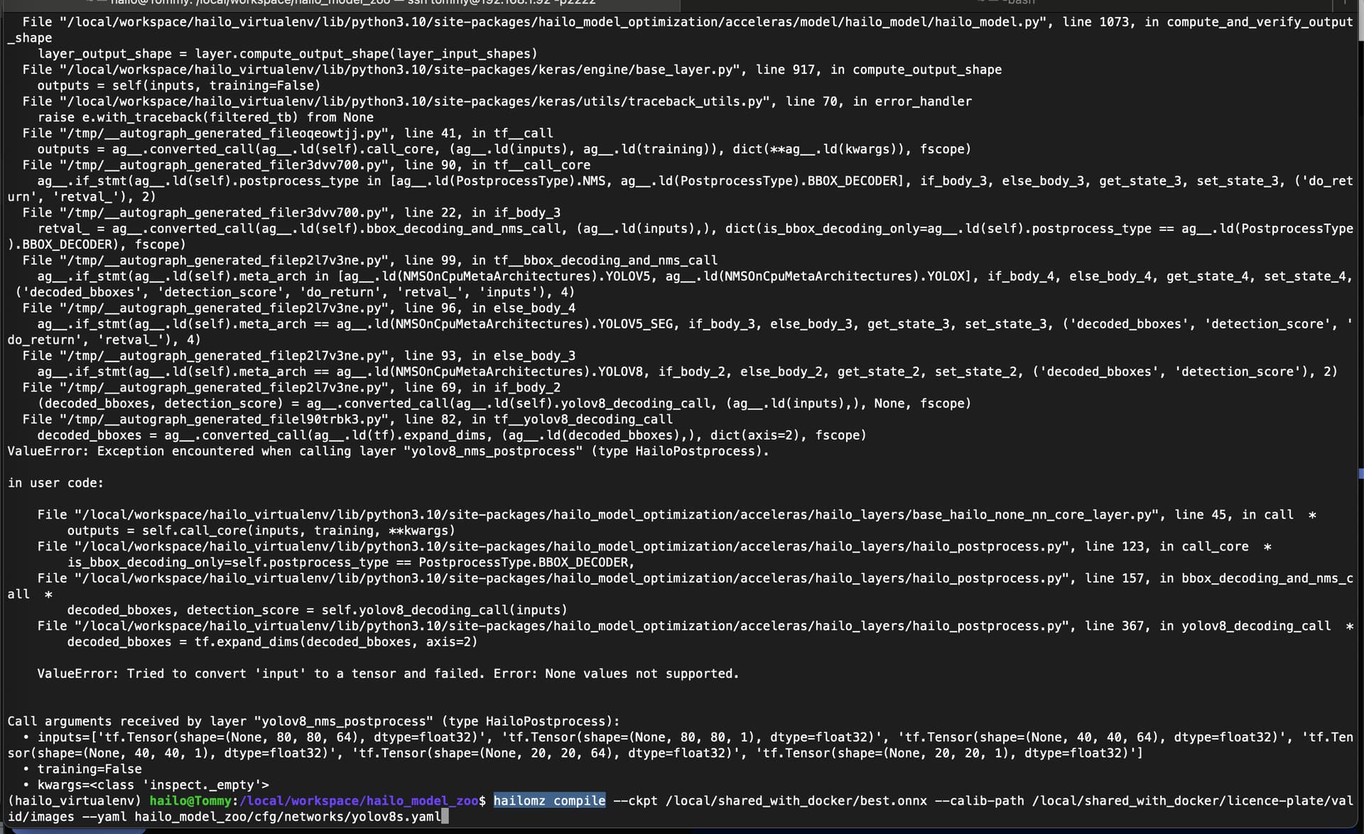

Compiling my onnx file with this yaml hailo_model_zoo/cfg/networks/yolov8s.yaml file I having some issue
this is my command
hailomz compile --ckpt /local/shared_with_docker/yolov8s.onnx --calib-path /local/shared_with_docker/licence-plate/train/images --yaml hailo_model_zoo/cfg/networks/yolov8s.yaml
Error:

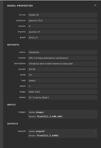

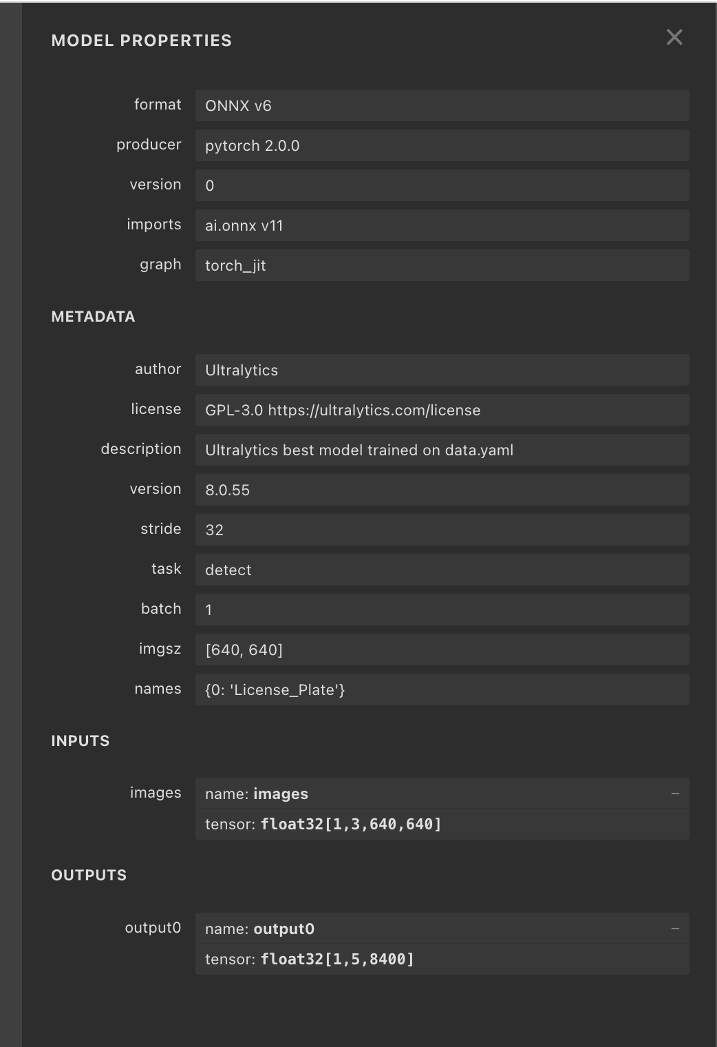

This are my outputs from neutron en in the image
Im not sure what im doing wrong
I am having the same or similar issue, I trained my own model base on Yolov8m following the instruction from hailo-rpi5-examples/doc/retraining-example.md at main ¡ hailo-ai/hailo-rpi5-examples ¡ GitHub. The training is success and I can run it on a Nvidia GPU using Yolo in Python, however when I try to run the hailomz compile, I got an error:
ValueError: Tried to convert 'input' to a tensor and failed. Error: None values not supported.
Call arguments received by layer "yolov8_nms_postprocess" (type HailoPostprocess):
  • inputs=['tf.Tensor(shape=(None, 80, 80, 64), dtype=float32)', 'tf.Tensor(shape=(None, 80, 80, 3), dtype=float32)', 'tf.Tensor(shape=(None, 40, 40, 64), dtype=float32)', 'tf.Tensor(shape=(None, 40, 40, 3), dtype=float32)', 'tf.Tensor(shape=(None, 20, 20, 64), dtype=float32)', 'tf.Tensor(shape=(None, 20, 20, 3), dtype=float32)']
Here is the complete terminal output:

from what I understand is that your model should have specific output that the post process nms is looking for, you can check in the file
			"name": "yolov8n/bbox_decoder41",
			"stride": 8,
			"reg_layer": "yolov8n/conv41",
			"cls_layer": "yolov8n/conv42"
			"name": "yolov8n/bbox_decoder52",
			"stride": 16,
			"reg_layer": "yolov8n/conv52",
			"cls_layer": "yolov8n/conv53"
			"name": "yolov8n/bbox_decoder62",
			"stride": 32,
			"reg_layer": "yolov8n/conv62",
			"cls_layer": "yolov8n/conv63"
you can check with https://www.neutron.app/ the output of your model, but if you model dont have 3 outputs yolov8letter/convTheNumber it will fail in the post-process
you are right the solution that I gave you is for some error when we are retraining and these outputs (yolov8x/convNumbers) don’t appear.
and maybe it’s ok that a model that you grab don’t have that ouputs and maybe it’s possible to add to that model theses output for the nms process but not sure how to do it, @Nadav maybe can clarify, why a model dont have this outputs, and how we can added it.
this is the app sorry https://netron.app/
