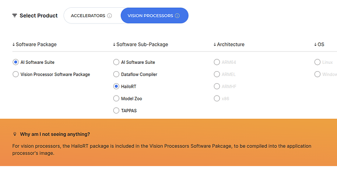

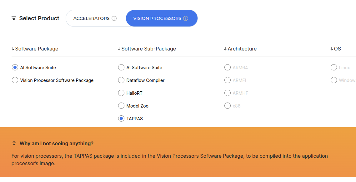

The documentation describing the installation still mentions do download the following:

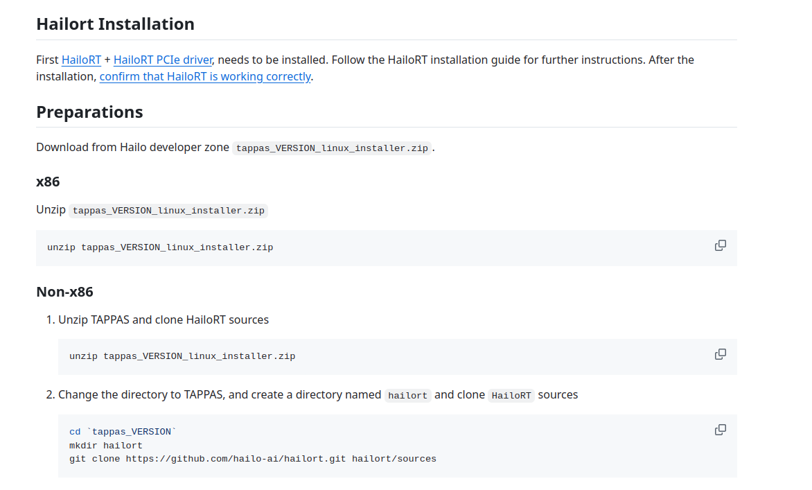

For Docker
Download from Hailo developer zone tappas_VERSION_ARCH_docker.zip and unzip the file, it should contain the following files:

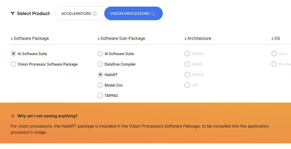

For Vision Processor, this file does not exist, at least not where the corresponding file for the accelerator would be:
The Vision Processor Software Package does also not contain the Tappas package.
Manual Install
According to the manual installation instruction, I should install HailoRT and then Tappas:
But again, those files do not exist in the Software Download Center or the Vision Processor Software Package
