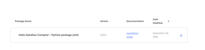

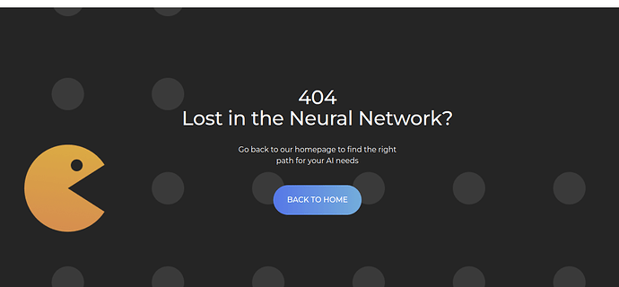

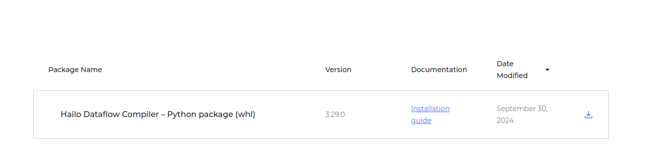

The link for the installation guide for Hailo Dataflow Compiler doesn’t work.

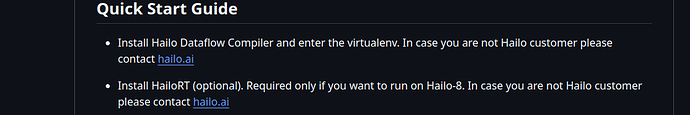

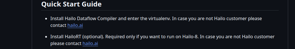

To run the Hailo Model ZOO, there are few lazy, non-working instructions that require the dataflow-compiler to be installed.
