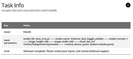

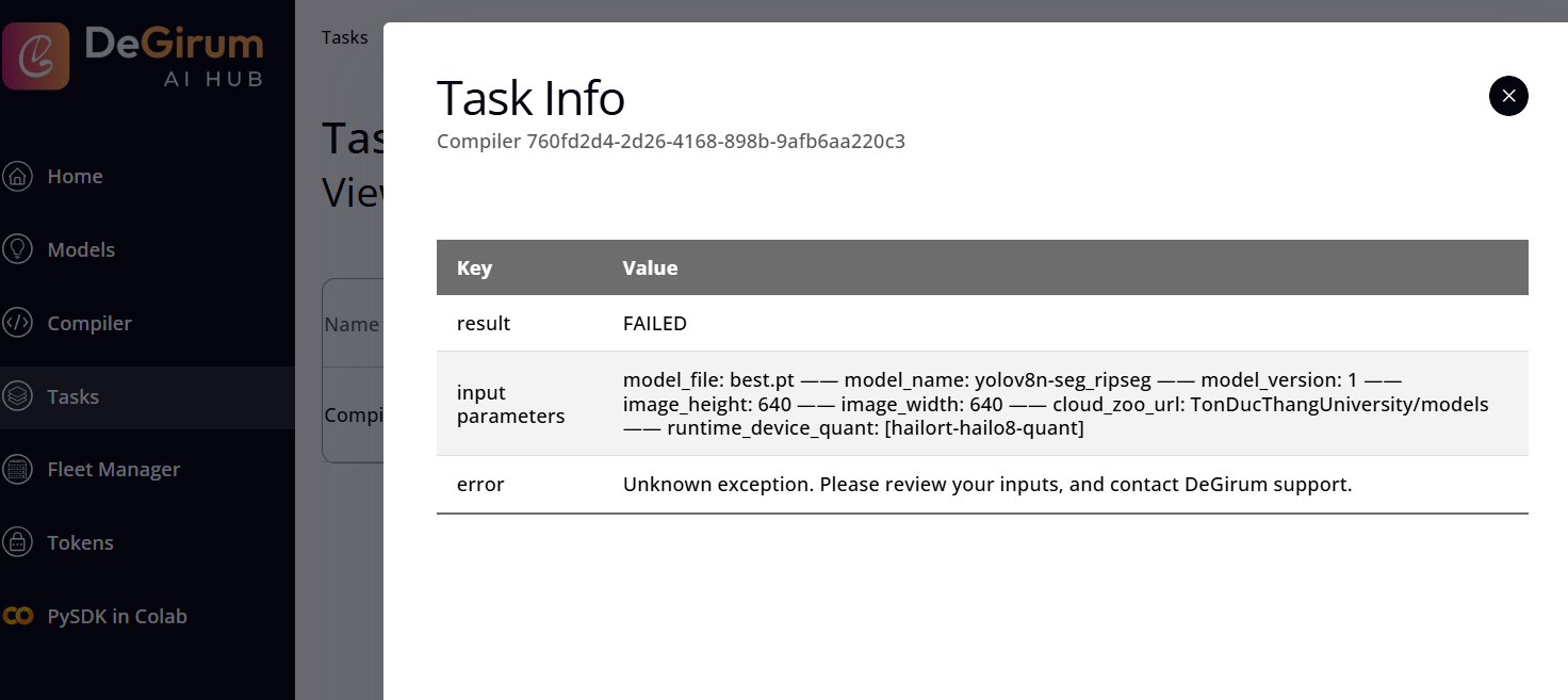

I used Derigum AI Hub to compile yolov8n-seg.pt to hef but it gives me this error:
Hi DevPhamPham,
The error occurs because our cloud compiler does not properly handle EMA models yet.
In the meantime please use this script to re-save your checkpoint, and then resubmit your task in the cloud compiler.

Thank you for your guidance, but I am still encountering the same error following your instructions.
