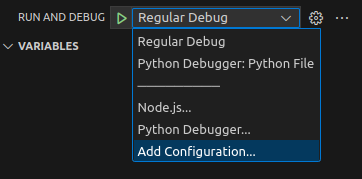

  5. In VS Code, open “Run & Debug” view from the “Activity Bar”, and add new configuration to launch.json:
    "version": "0.2.0",
    "configurations": [
            "name": "Regular Debug",
            "type": "debugpy",
            "request": "launch",
            "program": "${file}",
            "args": ["--input", "rpi"]  // optional
  1. While active open file (because “program” param set to ${file}) is the Python application, for example “detection.py”, run the configuration. This will try to debug the code but will show some error, while a Python debug terminal will open representing Pi remote folder with the code.
