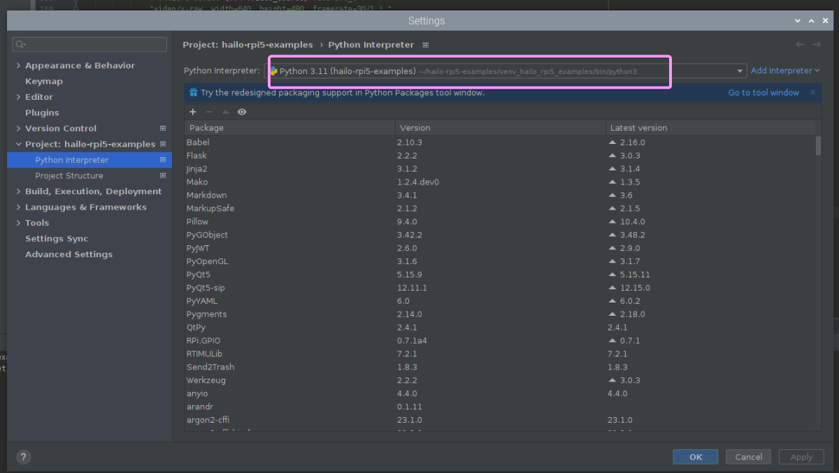

- Enter pychram’s setting > Project > Python interpreter > Add interpreter > direct it to
/hailo-rpi5-examples/venv_hailo_rpi5_examples/bin/python3. That will allow you pick it from the run/debug window

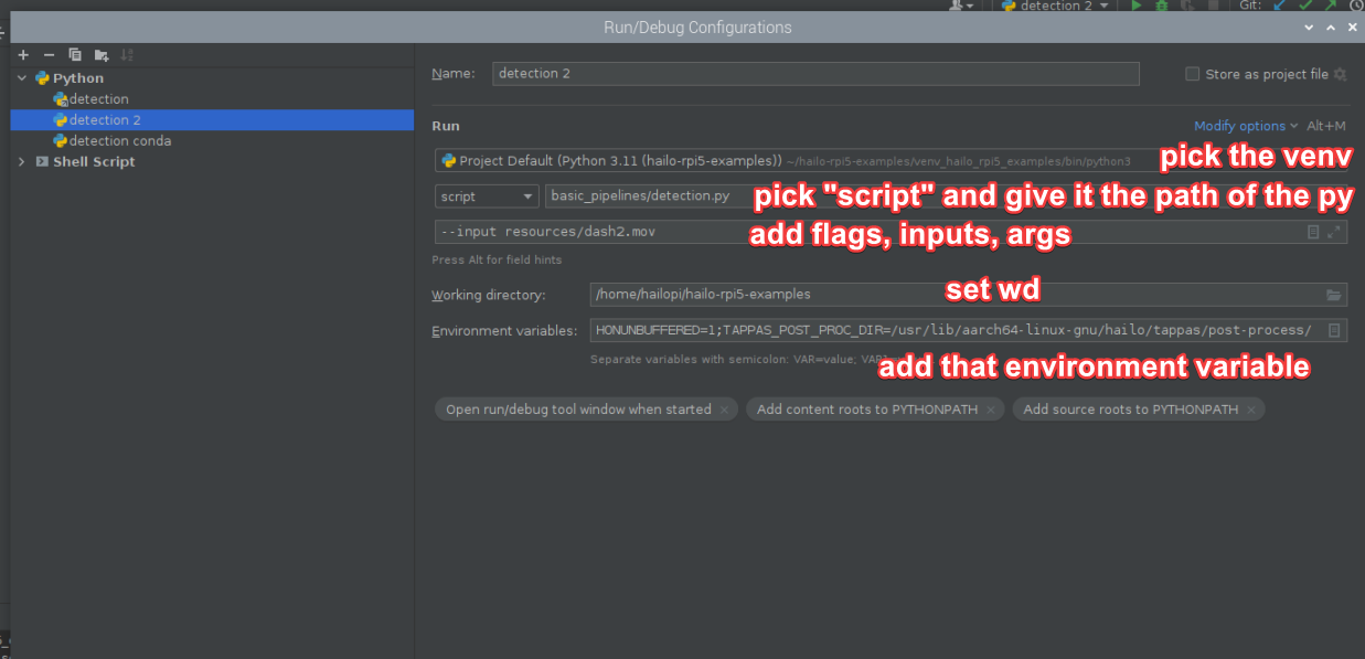

- on run/debug:
the text from the environment variables: PYTHONUNBUFFERED=1;TAPPAS_POST_PROC_DIR=/usr/lib/aarch64-linux-gnu/hailo/tappas/post-process/
it is obviously depend by your installation, but I did it as the “getting started” suggests, I assume you will too.

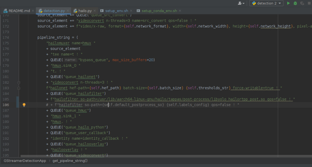

on the py file, under
get_pipeline_string, replace line 106 with 105:
+ f"hailofilter so-path=/usr/lib/aarch64-linux-gnu/hailo/tappas/post-process/libyolo_hailortpp_post.so qos=false ! "

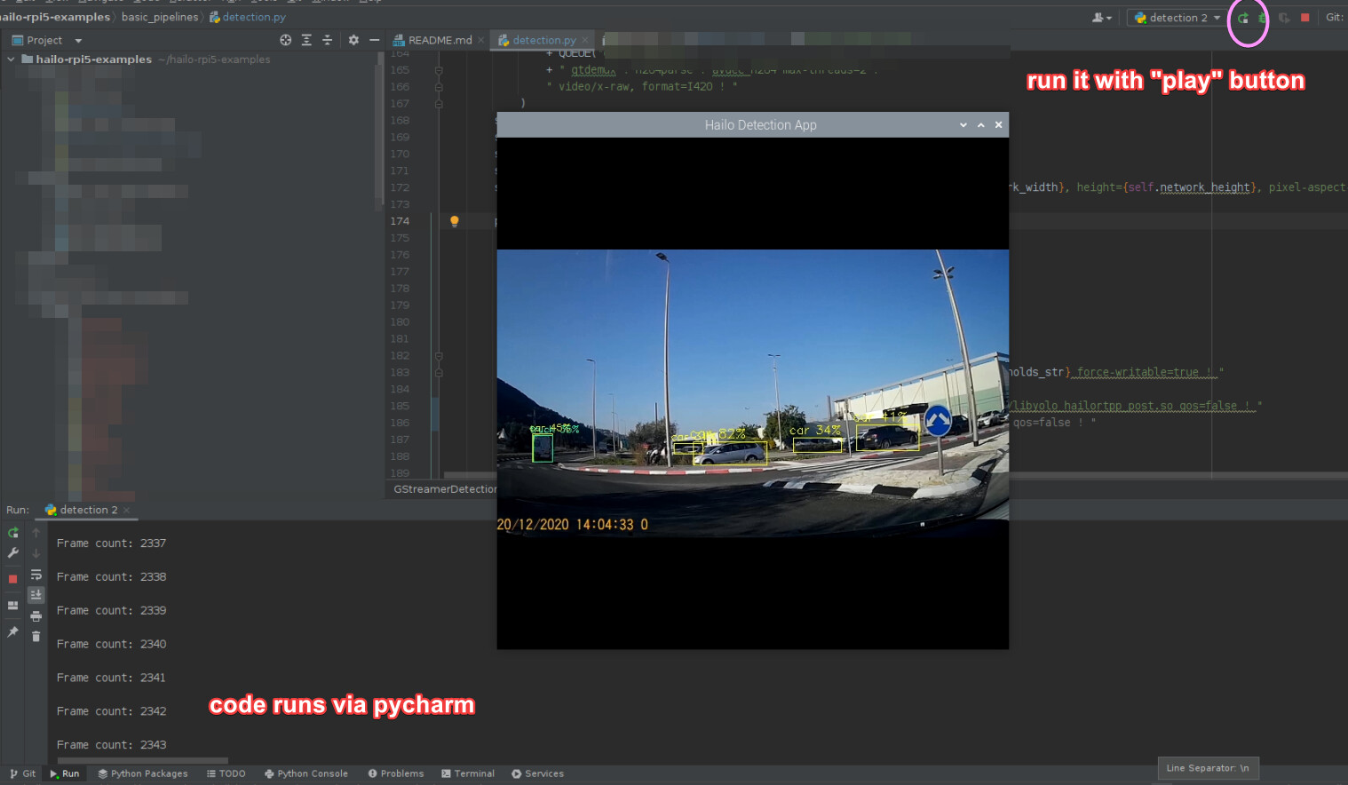

Now the app runs via pycharm:
- NOTE: the debugger triggered properly by breakpoints,
Except for breakpoints the app_callback which are being “overlooked” and I haven’t figured it out yet. (will update here once I’ll fix it)
