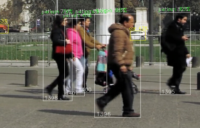

Changing boxes size will be able do in USER_CALLBACK_PIPELINE(in user_data.use_frame), but I find GStreamer rewrite some output at DISPLAY_PIPELINE.I find the user_data.use_frame is false. So I think that part never run. I dont find yet where to change.
So making some logic after detection can change your boxes.
I actually have simular problem I want change boxes text from person to some action. Like sitting, standing. I can write to console but not in frame directly. I want use for demonstration.

Hii Thanks for help.
I it is not functional. Becouse using destection.set_label(“sitting“) say set_label not defined. But I find I can add new label over existing it is not best sollution
new_label = "sitting"
hailo.HailoDetection(bbox=bbox, label=new_label, confidence=confidence)
roi.add_object(new_det)
And about OpenCV that work good (for circle, lines, text). I don’t know before I need use –use-frame as parametr to use it.
