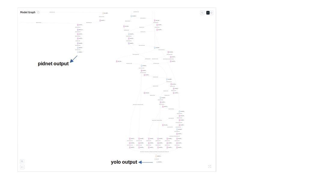

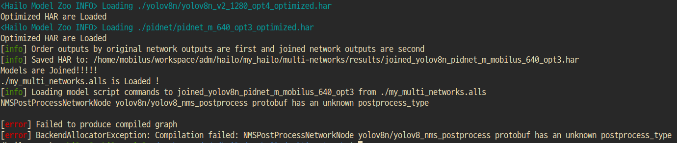

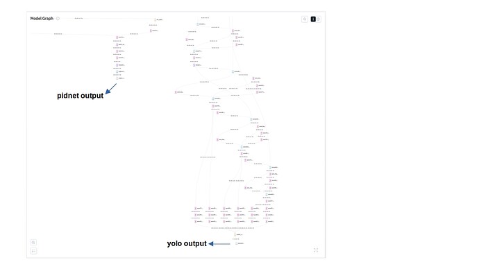

This is my joined HAR structure and Error Log of yolov8n postprocess part from compiling.

2024-09-02 17:55:55,696 - ERROR - hailo_tools_runner.py:431 - Failed to produce compiled graph
2024-09-02 17:55:55,984 - ERROR - hailo_tools_runner.py:219 - BackendAllocatorException: Compilation failed: NMSPostProcessNetworkNode yolov8n/yolov8_nms_postprocess protobuf has an unknown postprocess_type
