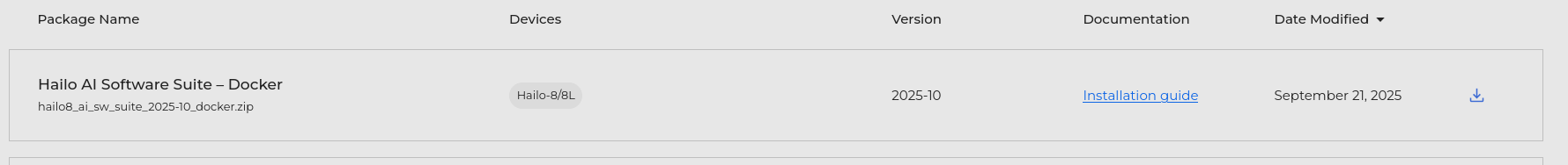

Hello, thank you for you answer, i am using docker, which i download from https://hailo.ai/developer-zone/software-downloads
