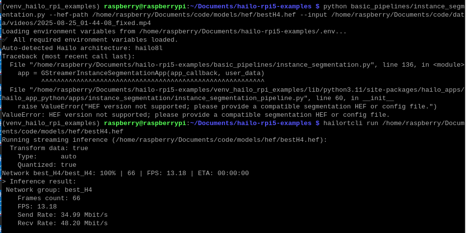

HEF version not supported, you will need to provide a config file

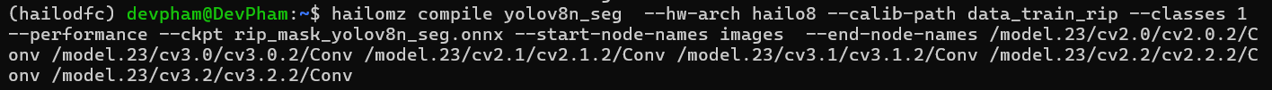

i have train my dataset with yolov11n-seg, then i compile with yolov8n_seg by declaring the last end nodes, after having the hef file, i run the command on raspberry pi 5 and get the following problem, i don’t know how to fix it? can you help me?

and when compiling the yolov11n-seg model, I just need to do the same as yolov8n-seg but change the end-node names, right?

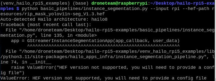

Can you help me? I’m having a similar issue. My model is based on yolov11-x-seg, and I don’t know anything about a JSON config file. Do I need to create it manually?

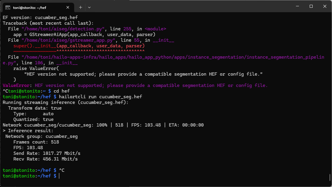

I also have a similar problem, with a yolov11 segmentation network converted to HEF.
I applied for an early access to DeGirum Cloud Compiler.
What I’m curious about is that DeGirum does mention support for semantic segmentation, but it doesn’t mention instance segmentation support?
Is there any additional information on config file available?"
Hi @Toni_Stojev
YOLO segmentation models which are instance segmentation models are supported by the cloud compiler. We will change the wording on the page to clarify this. Thanks for pointing it out.
