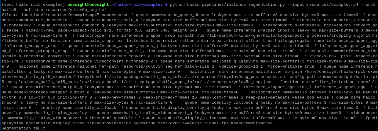

Segmentation fault on running custom yolov5n_seg.hef
Hello, i trained a yolov5 segmentation model with my dataset on raspberry pi 5, but once i try to execute i get a segmentation fault. If i swap my yolov5n_seg.hef with deafult yolov5n_seg.hef (from hailo-rpi5-examples) it works correctly.

Ok i resolved the issue on yolov5seg, now it works! There’s no guide about on how to change json file, in particular in the field outputs size and outputs name everything must go in order.

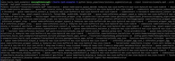

hi @Andrew92 i’m getting the same error as you. where is the exact location of the config.json file. are you running instance_segmentation.py after changing the config file?
