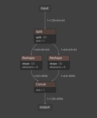

sets C=128). It seemed like some memory limitation so I tried to split the tensor into two, perform the reshape and concatenate it (example_2.py
), but it resulted in an error that I don’t understand.

(hailo_virtualenv) hailo@quczer-seagle:/mnt/bchw_to_bcp$ python example_2.py
Saved ONNX model to /mnt/bchw_to_bcp/example_2.onnx
onnx.__version__ = '1.16.0'
torch.__version__ = '2.6.0+cu124'
__import__('hailo_sdk_client').__version__ = '3.31.0'
[info] Translation started on ONNX model model
[info] Model Optimization is done
Compiling model...
[info] To achieve optimal performance, set the compiler_optimization_level to "max" by adding performance_param(compiler_optimization_level=max) to the model script. Note that this may increase compilation time.
Layer output_layer1 can't spatial reshape from (1, 4096, 128) to (64, 64, 128) without a successor format_conversion.
consider adding the following command to model script: "reshape_layer = format_conversion(output_layer1, concat1, hailo_rgb_to_tf_rgb)"
[error] BackendAllocatorException: Compilation failed: Layer output_layer1 can't spatial reshape from (1, 4096, 128) to (64, 64, 128) without a successor format_conversion.
