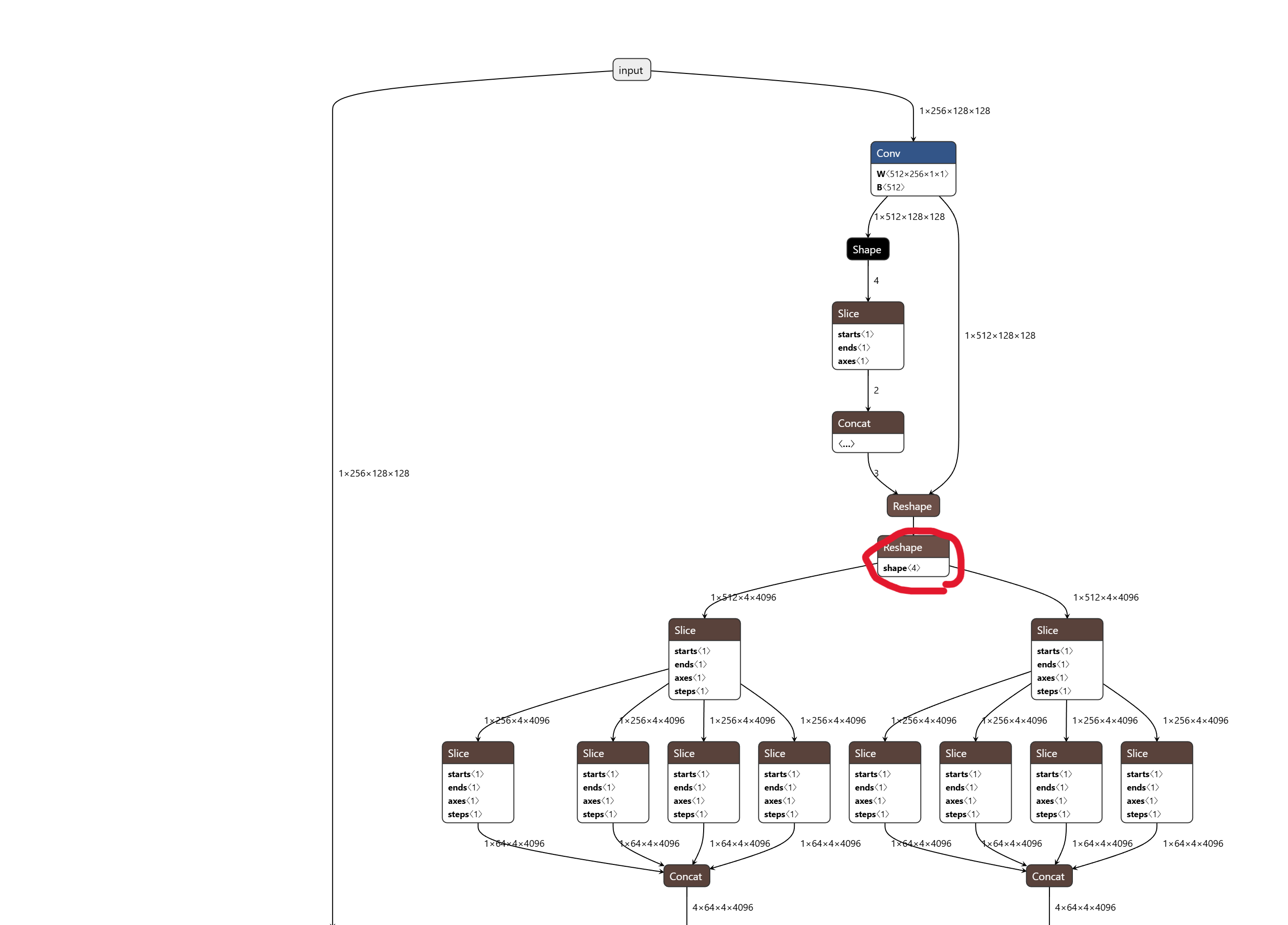

Here is ONNX visualization
Are there any constraints that prevent certain layers(e.g. flatten layer) from being used before the reshape layer?
Hey @HappySniper95 ,
Thanks for sharing the graph , these are my thoughts :
Root Cause
Hailo’s Dataflow Compiler does not support shape propagation through runtime shape-calculation logic, even if the resulting values are constant at inference time.
So even this setup:
Shape → Slice → Concat → Reshape
Fails Hailo’s requirement of fully static Reshape.
Recommended Fix
Hardcode the shape using a Constant node upstream:
  • Make sure the shape input of the Reshape comes directly from a constant initializer, not any ops like Shape, Slice, etc.
Also verify in Netron that the reshape node’s second input is a solid constant and not part of a calculation chain.
