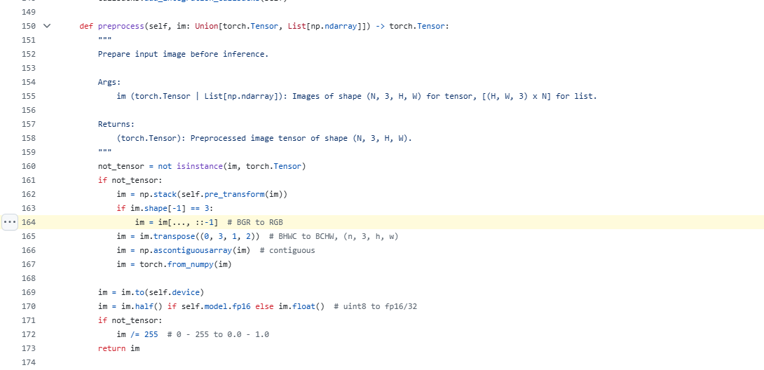

Thank you for the detailed answer.
The simplest option worked. I changed BGR->RGB before sending to Hailo and it improved recall from 0.75 to 0.89, very close to original pytorch YOLO model.
I am not 100% sure where is the problem as I use cv.imread() for both Pytorch, Hailo.
Looks like YOLO internally transfers BGR to RGB and we need to do the same manually.
Hi @Ivan_Bendyna
Yes, YOLO internally converts BGR to RGB in its preprocessor function: ultralytics/ultralytics/engine/predictor.py at main · ultralytics/ultralytics
