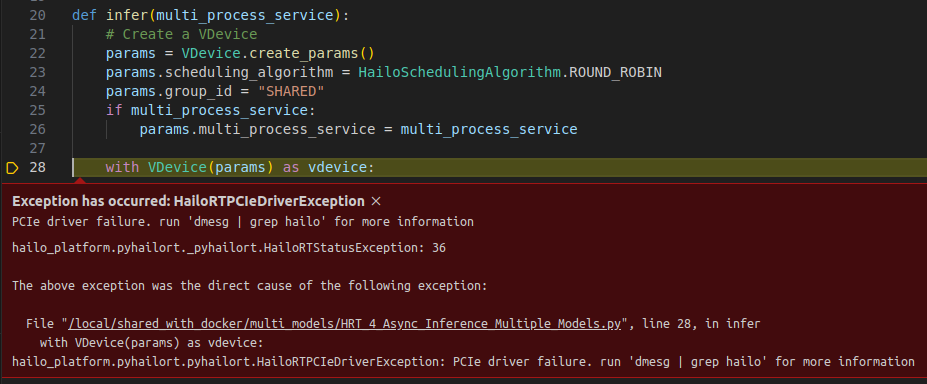

However I am trying to run the “HRT_4_Async_Inference_Multiple_Models_Tutorial” from “hailo tutorial” and I have the following error msg:

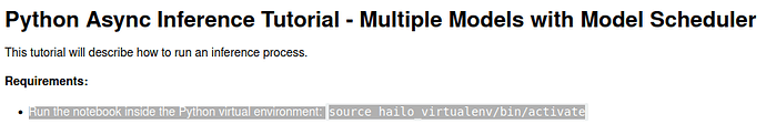

I realised the tutorial has mentioned:
If I understand correctly it is required to run the code outside docker container right?
Does it mean the Model Scheduler does not work in docker container environment?
I need to run 2 models on 1 Hailo-8 chip, I hope I am following the correct tutorial.
You can run the code inside the container as well. However you must:
./hailo_ai_sw_suite_docker_run.sh --resume --hailort-enable-service
The model scheduler also works in a docker container.
