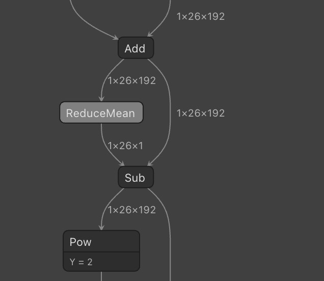

This happens during a ReduceMean operation. Basically, the SDK expects self.input_format to be defined, but it’s None, so it crashes when trying to map axes.
Why This Happens
Your model has a ReduceMean node working over a shape like [1, 26, 192] → [1, 26, 1].
The SDK tries to evaluate if this is a “null-op” by checking the axes.
If shape inference is off or your model is over-simplified, then input_format doesn’t get set — and boom, crash.

I am seeing this exact error, but none of the suggested fixes work for me.
In my case, I have two ReduceMean operators following each other. Both of them have the ‘axes‘ attribute set (1 and -2 respectively), and I have set the flag ‘disable_shape_inference=False’. I get the error regardless of any simplification of the net.
Your crash is happening because the translator gets confused with the tensor layout when you chain two ReduceMean ops with axes 1 and -2.
