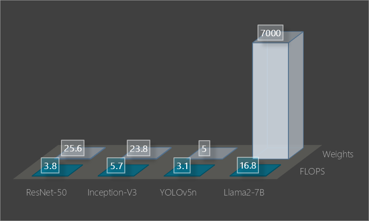

Thank you for using Hail community forum. And we’re super appreciative of your diligent try to make this work. At the moment LLMs are not supported by Hailo-8 product line.
Understood, but neural networks are neural networks. There must be a way to work around this, right?
Technically you are right, but with LLM the challenge is different. With traditional CNNs there is much more compute compared to weights. With LLM it’s all around the ability to bring the weights from memory. See comparison below:
So, while technically true, we don’t think that the performance would be attractive enough. This is the reason that we are working on an alternative HW.
Hmm. that is true. bringing so much weights from memory is definitely a big task. Now I understand what you mean. But the thing is most people using Edge devices like the raspberry pi are already thinkering like me to get to run AI/LLM models faster, but adapting the Hailo 8 you get alot of TOPS. and for me any performance boost is really great. even if it’s 10-15 tokens per second.
Also is it possible for you explain the error that I am facing? I know it has to do something with the dynamic layers inside the LLMs but couldn’t really grasp the error that much.
You’re right, and we’re also completely aware of this. We are working on a solution that would be attractive for makers.
Beyond the shear size of the model, the basic op - MHSA has some unique features compared to CNNs. It mighe be that the attention machanims looks different than what the SW knows how to parse, but in oder to be certain, we would need to look at the ONNX.
