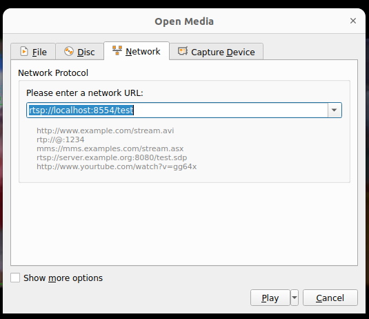

or open a VLC and configure it according to this:
open vlc-player → Media → Open Network Stream, set network url as:
rtsp://localhost:8554/test
