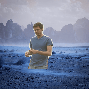

That helped me lot. Unfortunately the provided code doesn’t produce any mask at all. I’m assuming it’s something to do with how mask_overlay is created. I have managed to get it working though. I had to add binary mask, and ensure it’s applied to all three color channels:
  binary_mask = (mask_resized> 0.2) * 255
  # Create a mask overlay for the person
  mask_overlay = np.zeros_like(frame)
  mask_overlay[y_min:y_max, x_min:x_max, :] = cv2.merge([binary_mask] * 3)

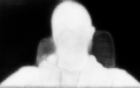

I’m not too satisfied with the results though. The resizing of the mask produces extremely pixelated image:
So I’ve played around with interpolation method and INTER_CUBIC seems to be quite good:

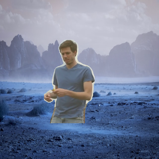

The problem I have personally is the mediocre results on the final video. I am using this free video from pexels - https://www.pexels.com/video/baseball-training-852399/ and here is what I got:
Obviously, ignore the perspective and lighting issue. I believe those, once set correctly will add to the realism, but so far I’m focused on the mask itself.

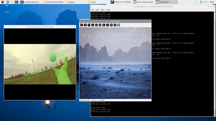

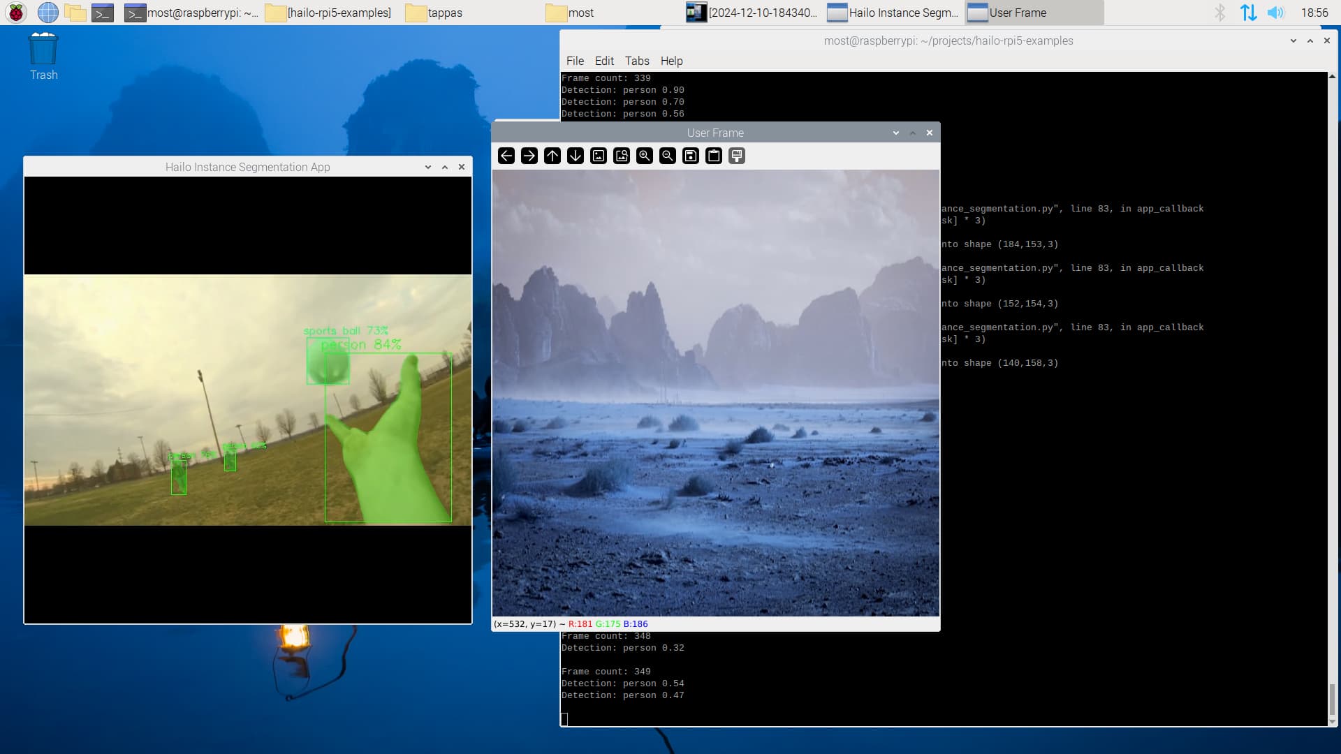

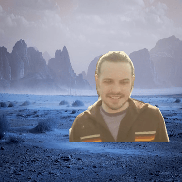

More importantly sometimes the mask doesn’t appear at all:

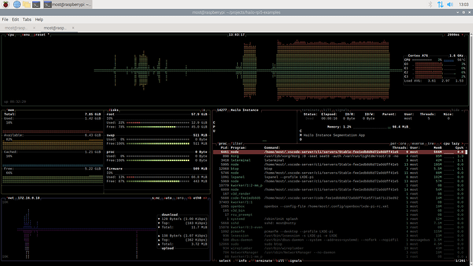

Additionally I see extreme CPU usage on my RPi5 when utilizins script with PiCamera module:

  1. How to get better quality mask?
  2. Why sometimes mask doesn’t appear on the buffer frame?
  3. How to replace the main preview with the one from the buffer?
