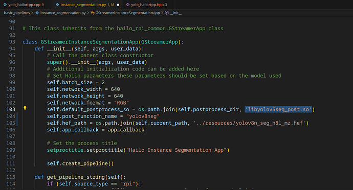

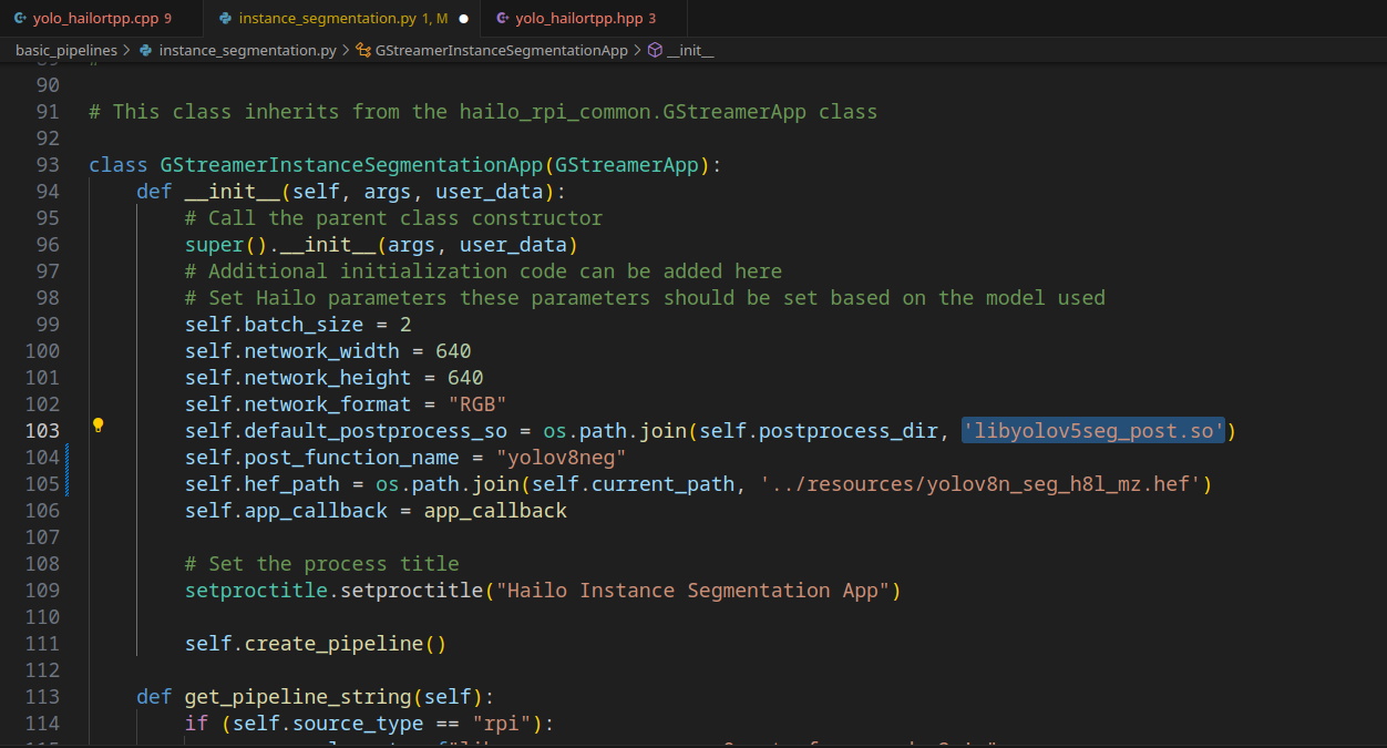

Hello @Omer,
I was able to get the hef for my retrained model. But I am stuck at this step to get the custom post process library object. I am not able to find how to generate this .so.
Can you please help me with this?
Hi @shubham,
The example you are trying to run is specific for yolov5_seg. You can use the example for yolov8_seg here:
