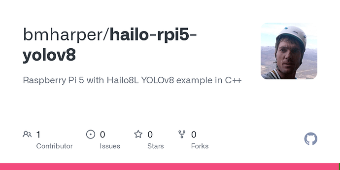

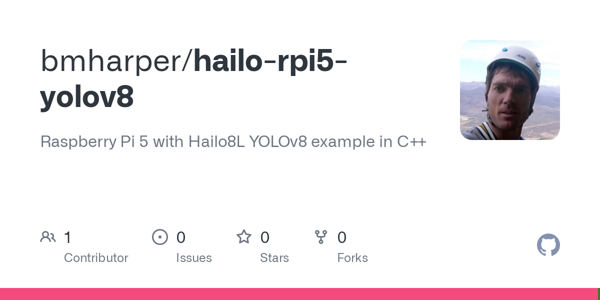

I’ve created a minimal standalone demo that reads just a single image file, runs inference on it, and prints the results to the console:
(sorry, I’m not allowed to include an actual HTTP link in my post)
I find it much easier to start from a minimal example like this.
Hi, congratulations for the essentiality of the demo, with a resize of the image it is perfect.
Hey @rogojin,
Nice work! Thanks for contributing to the community.
Can’t wait to see what awesome projects you come up with next.

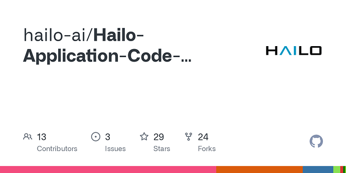

I’ve successfully tested the ‘general_detection_inference’ example with yolov8s.hef, available at this GitHub link
(Hailo-Application-Code-Examples/runtime/cpp/detection/general_detection_inference at main · hailo-ai/Hailo-Application-Code-Examples · GitHub).
However, I’m encountering issues with other .hef files downloaded from the Hailo Model Zoo, such as Yolov8m.hef or Yolov8L.hef.
The error message is shown as follows:
./vstream_detection_example_cpp -hef=yolov8n.hef -input=test-image-640x640.jpg
[HailoRT] [error] CHECK failed - HEF file length does not match
[HailoRT] [error] CHECK_SUCCESS failed with status=HAILO_INVALID_HEF(26)
[HailoRT] [error] Failed parsing HEF file
[HailoRT] [error] Failed creating HEF
Failed to configure network group yolov8n.hef
Could someone please help me understand what might be going wrong?
Thank you!
