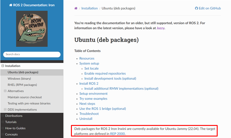

Unfortunately, at the installation stage, I get an error because of packages that are not available to me. I searched the internet and found in the official documentation that ROS2 Iron is currently available for Ubuntu 22.04.
