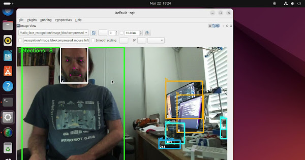

@Kyrikakis thanks;-) I took your repo and I’m running it natively on Ubuntu 24.04 on a Pi5;-) It works pretty well now;-)
I found one problem, where the RasiOS packages and the normal tappas install script leave out some libraries in the rpi5 case:-( But that’s fixed in my build now;-)
