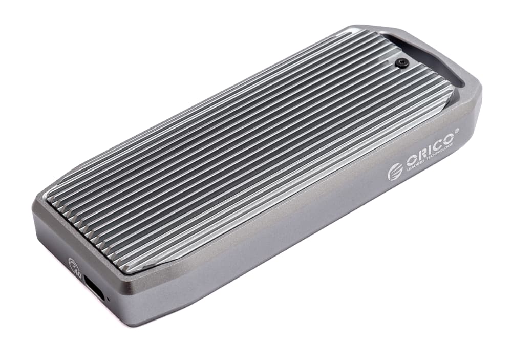

Below are images to help identify the device when purchasing online.

- Model: M2V01-C4 M.2
- Product Name: M.2 NVME SSD Enclosure
- Chip Used: JHL7440 (Thunderbolt 3 controller from Intel)

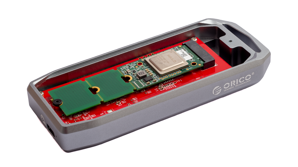

Hailo-8 M.2 module
The tested adapter supports four PCIe lanes, allowing you to use a Hailo-8 M.2 module with either a key M or key B+M (two PCIe lanes). When connecting the Hailo chip to the enclosure, make sure to use the thermal pad provided in your Hailo-8 starter kit for proper heat dissipation. The enclosure is fairly massive and will allow running heavy workloads for an extended time.
Hailo-10H M.2 module
Update: The SSD enclosure also works with the Hailo-10H M.2 module. Make sure to use the thermal pad provided in your Hailo-10H starter kit for proper heat dissipation.
