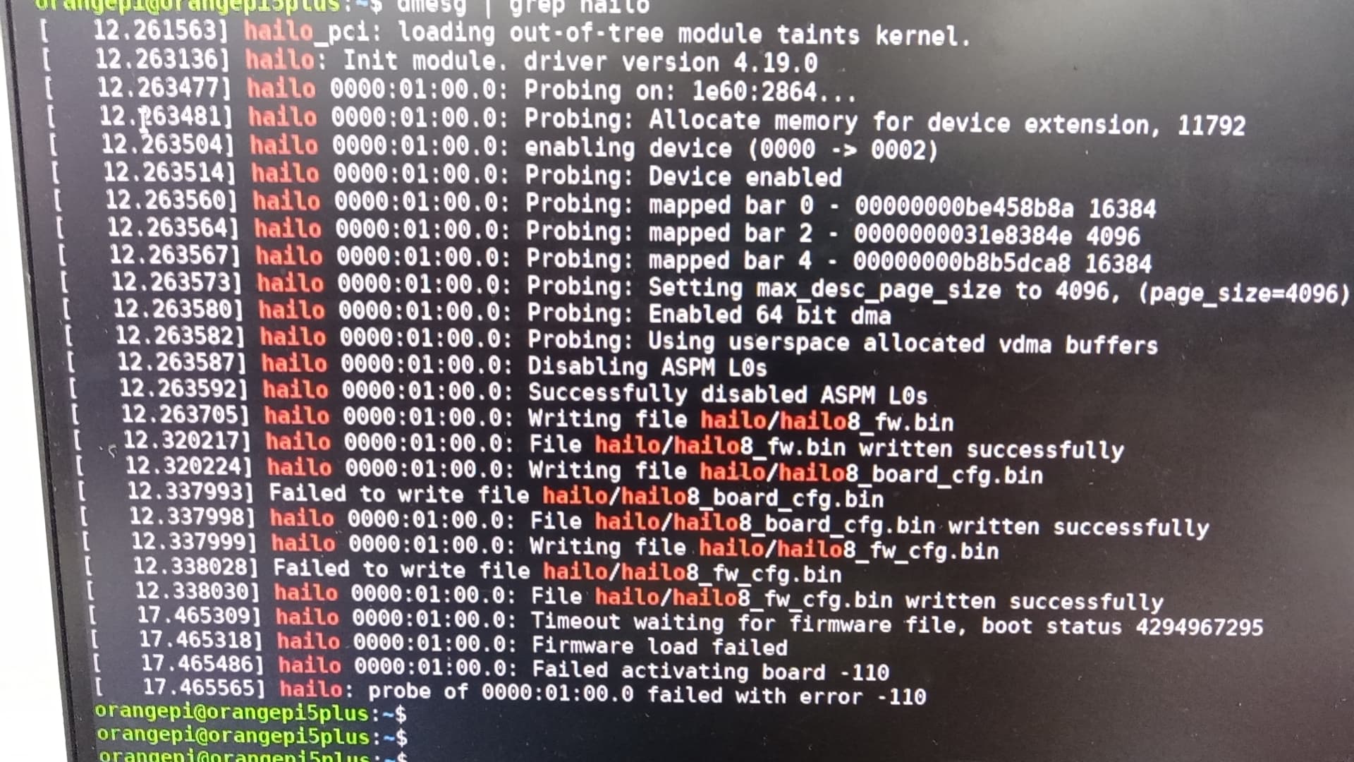

I am using an Orange Pi 5 Plus with Focal and kernel version 5.10.100. After installing linux-headers and the Hailo driver, when I input lspci, the device is detected. Furthermore, after rebooting and running hailortcli scan, the device ID is visible. However, after rebooting and scanning again, the device can no longer be detected. The logs show the following error. How can I resolve this?
What I mean is that the device’s state is different each time it restarts. Sometimes the device can load the firmware normally, but other times it fails to load the firmware properly.

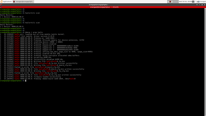

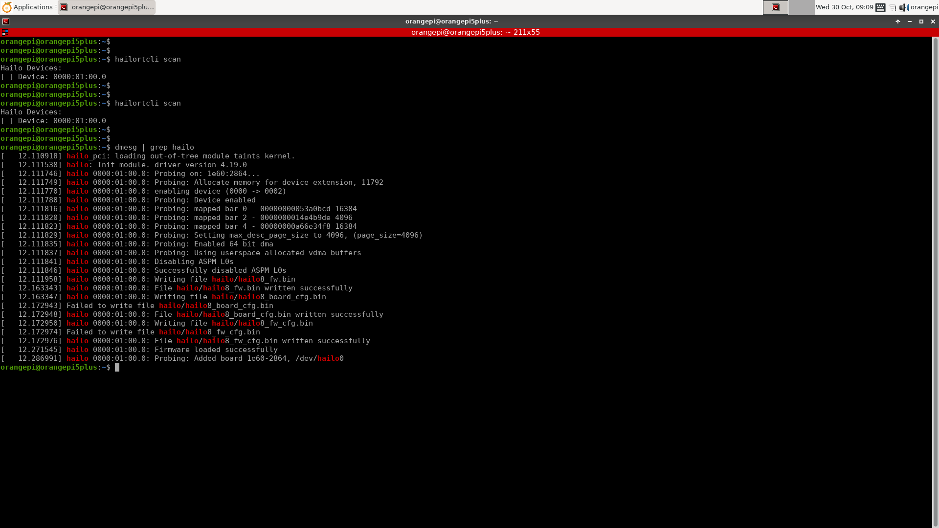

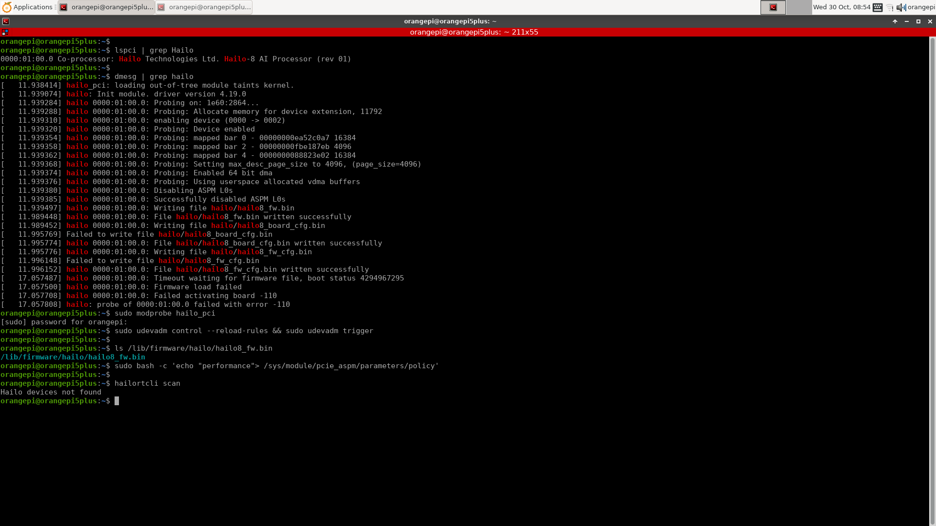

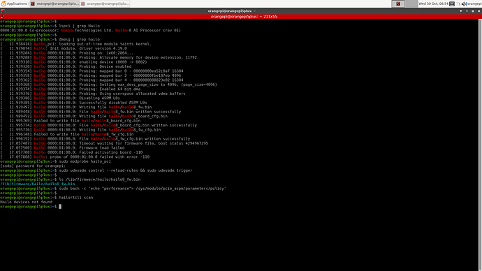

Hi @omria, thank you for your reply. After receiving your message, I followed your instructions. When I booted up the device and couldn’t detect Hailo, I took the following actions:
I want to remind you again that the phenomenon is different each time the device starts up. Sometimes it can detect the device as shown in the picture below, and sometimes it cannot detect it.
Hey @FANpa,
Let’s try troubleshooting the firmware and configuration files first:
  1. Check that these files exist in /lib/firmware/hailo/ with correct permissions:
    • hailo8_fw.bin
    • hailo8_board_cfg.bin
    • hailo8_fw_cfg.bin
Run this command to set proper permissions:
sudo chmod 644 /lib/firmware/hailo/hailo8_*.bin
If this doesn’t resolve the issue, we can try:
  1. Reinstalling the Hailo software
  2. Could you share the installation logs as text (not screenshots) afterward?
Note: Inconsistent detection can sometimes be caused by corrupted or mismatched firmware files, so reinstalling might help.
