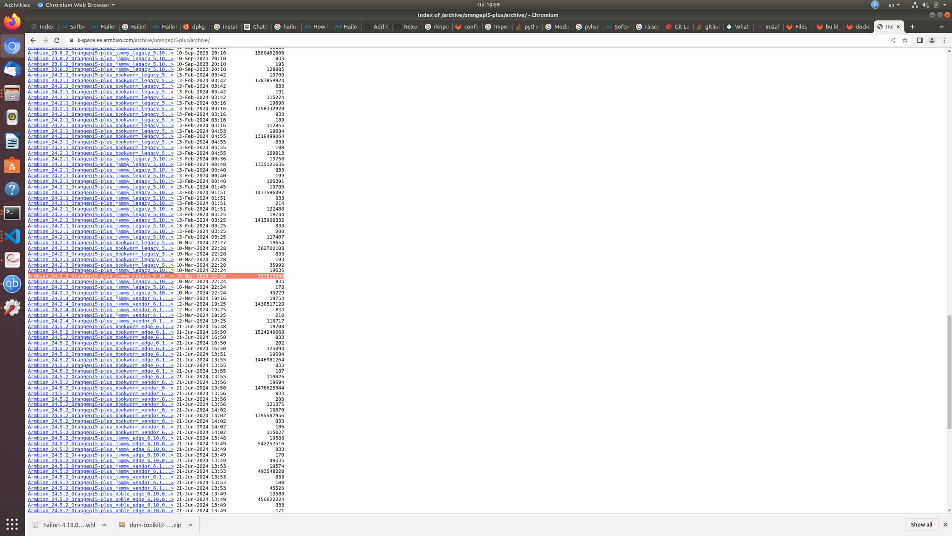

The solution is to use Armbian Linux v5.10. Hailort-pcie-driver 4.18.0 doesn`t work with Armbian Linux v6.1 now.
Could you please share the link to the OS that was used to resolve the issue?
thank you
@jsbf I downloaded Armbian_24.2.3_Orangepi5-plus_jammy_legacy_5.10.160_minimal.img.xz here:
Index of /archive/orangepi5-plus/archive/
This error is because linux-headers is not installed, and there is one under/optHis installation package, you can try to install it using sudo dpkg --install *****.deb
