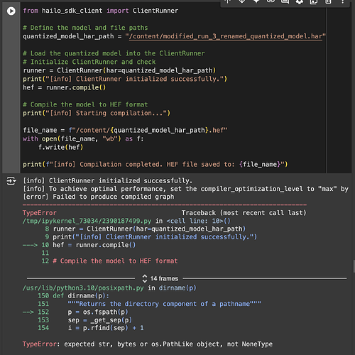

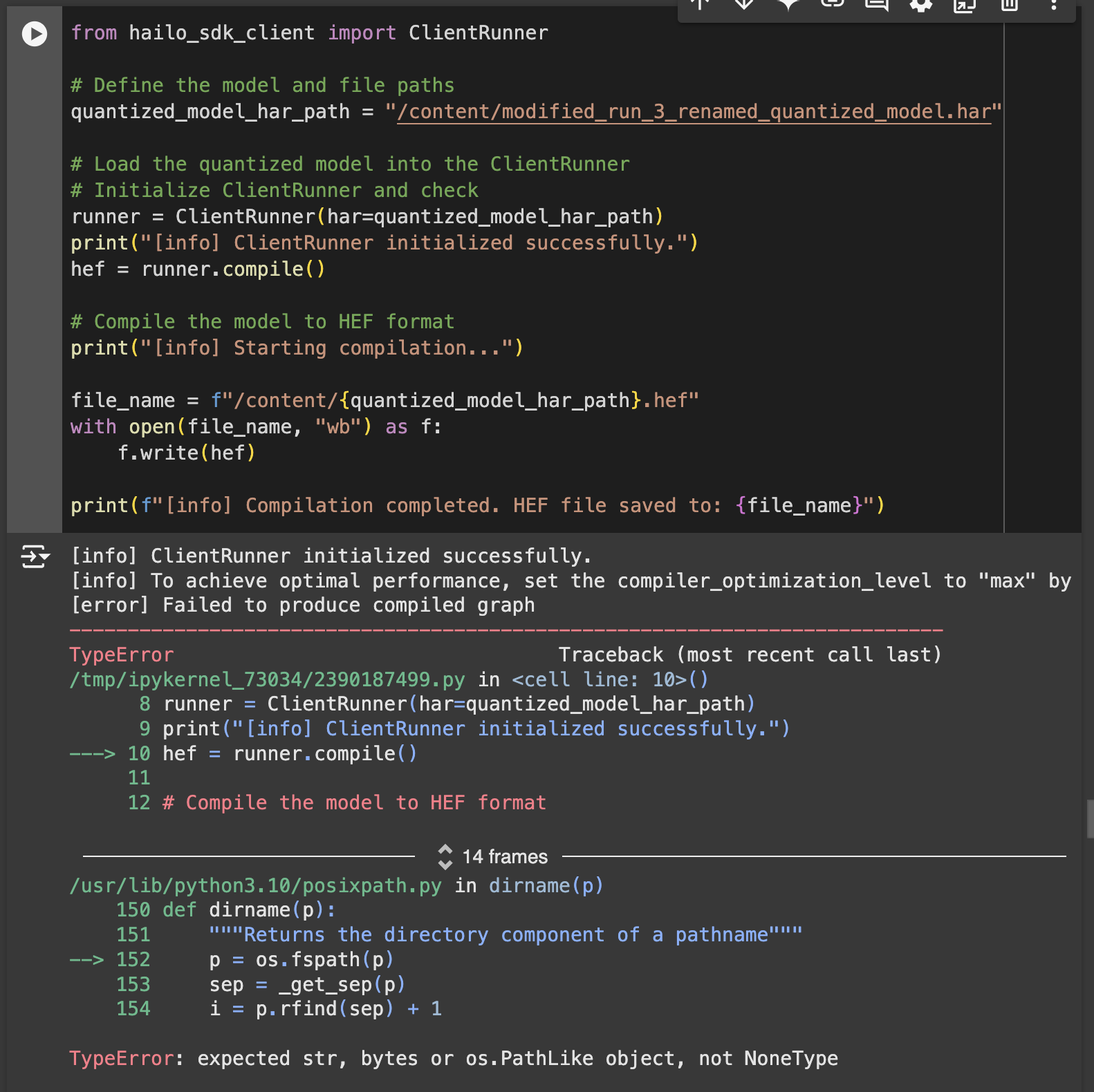

Currently trying to compile a modified version of YoloV11 that I retrained, but I keep running into the error below:
However, I already rechecked the end nodes with netron, and they seem right as far as I can tell. My modified version of YoloV11 has P4/P5 detection, as I removed P3.

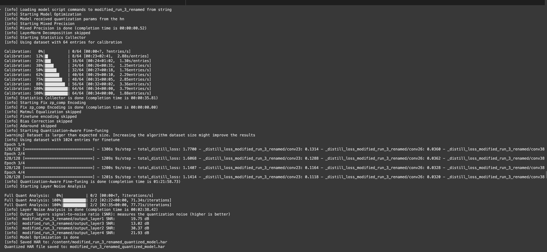

I already referenced others issues on this topic, and they just said to check the end nodes, as there should be two end nodes per feature map, so I have 4, so was just wondering if someone could help double check my nodes. Below is my optimization step.
Can someone just verify my steps? I have no idea what I did wrong.
